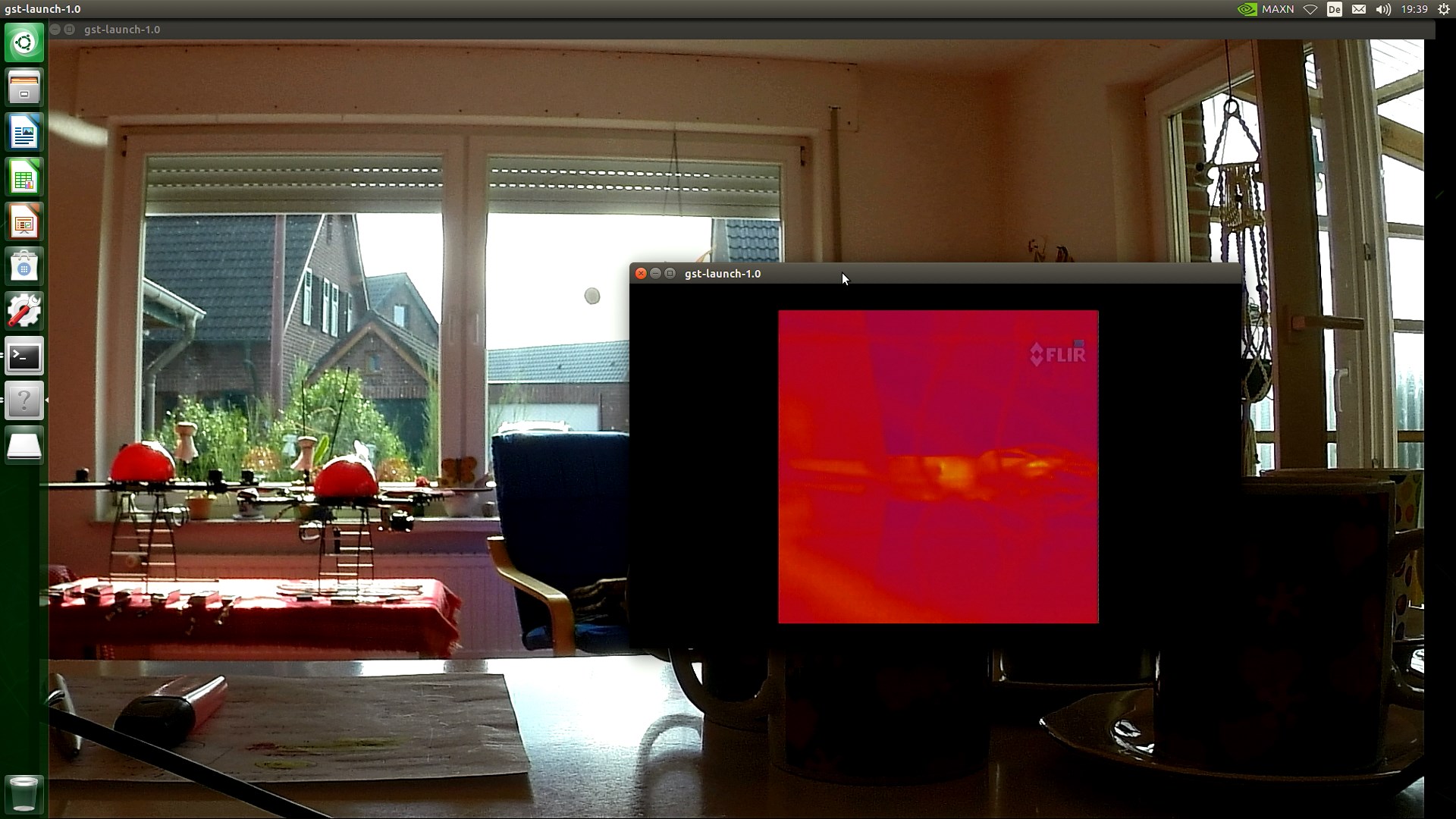

I have connected two cameras via two USB3-HDMI adapter and read the streams with gstreamer, see pictures.
$ gst-launch-1.0 -v v4l2src device=/dev/video<b>0</b> ! video/x-raw,framerate=30/1,width=1280,height=720 ! xvimagesink

This is the gstreamer code for the attached image (if I remember correctly)
The cameras are a thermalcamera and a Gopro. Alpha is the transparency. Nv… are Nvidia signal processor plugins.
With nvvidconv you can cropp (nvvidconv top=180 left=320 bottom=900 right=1600)
 gst-launch-1.0 nvcompositor name=mix sink_1::xpos=320 sink_1::ypos=132 \
 sink_1::width=640 sink_1::height=500  sink_1::alpha=0.5 ! nv3dsink \
 v4l2src device=/dev/video1 ! video/x-raw, framerate=30/1, width=1920, height=1080 ! \
  nvvidconv top=180 left=320 bottom=900 right=1600 ! alpha alpha=1 ! nvvidconv ! mix.sink_2 \
v4l2src device=/dev/video0 ! video/x-raw, framerate=30/1, width=640, height=480  ! \
 alpha alpha=1 ! nvvidconv top=32 left=112 bottom=450 right=538 ! mix.sink_1 \
