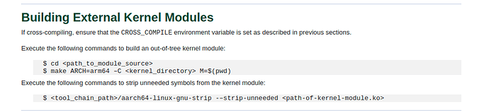

I try to build a External Kernel Modules on Jetson Xavier.
I find a document at here:
https://docs.nvidia.com/jetson/l4t/index.html#page/Tegra%20Linux%20Driver%20Package%20Development%20Guide/kernel_custom.html#
It seems easy to make a .ko file, but when I try to build it , I got
I have no idea about how to deal with it, I think the doucument is not easy to understand to a new bird.

Finally I can build something follow the guide, but it seems build all kernel rather than one module, should I build all kernel when I want to build only one kernel ?

Finally I write a Makefile to build single module .
KERNELDIR := /lib/modules/4.9.201-tegra/build
CURRENT_PATH := $(shell pwd)
obj-m := chrdev.o
default:
$(MAKE) -C $(KERNELDIR) M=$(CURRENT_PATH) modules
clean:
$(MAKE) -C $(KERNELDIR) M=$(CURRENT_PATH) clean
I will test it.
