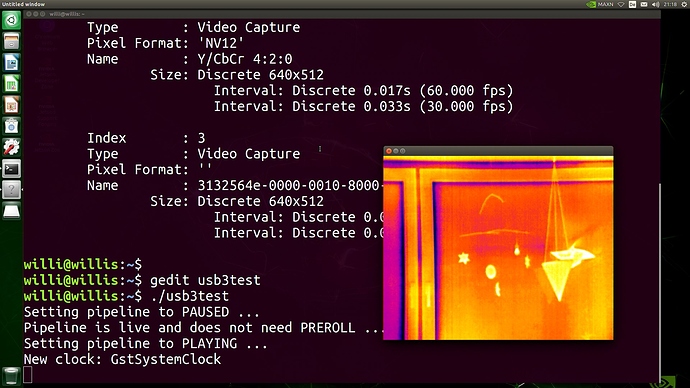

I would like to composite streams of 2 USB cameras. One is a thermal camera with an USB(2) port, one is a Gopro with an HDMI to USB3 adapter. Each camera alone works, see picture from the Thermalcamera, but the pipeline with nvcompositor terminates with the shown error.
If I use two cameras with the same HDMI 2 USB3 interface the pipeline works fine.
I think it is a format problem, but I am not very versed with gstreamer. It would be very nice if someone has some suggestions.
If I use both cameras in different pipelines in Python with Gstreamer the result has a great delay and very low framerate or is pending totally.
These are the data of the cameras.

Pipeline
gst-launch-1.0 nvcompositor name=mix sink_1::xpos=0 sink_1::ypos=0 \
sink_1::width=640 sink_1::height=512 sink_1::alpha=1 ! nv3dsink \
v4l2src device=/dev/video1 ! video/x-raw, framerate=30/1, width=1280, height=720 ! \
nvvidconv ! alpha alpha=1 ! nvvidconv ! mix.sink_2 \
v4l2src device=/dev/video0 ! video/x-raw, framerate=30/1, width=640, height=512 ! \
alpha alpha=1 ! nvvidconv ! mix.sink_1 \
Error message
willi@willis:~$
willi@willis:~$ ./testvv_boson
Pipeline is live and does not need PREROLL ...
New clock: GstSystemClock
Redistribute latency...
ERROR: from element /GstPipeline:pipeline0/GstV4l2Src:v4l2src0: Internal data stream error.
Additional debug info:
gstbasesrc.c(3055): gst_base_src_loop (): /GstPipeline:pipeline0/GstV4l2Src:v4l2src0:
streaming stopped, reason error (-5)
Execution ended after 0:00:00.314211458
Setting pipeline to READY ...
Setting pipeline to NULL ...
Freeing pipeline ...
willi@willis:~$
