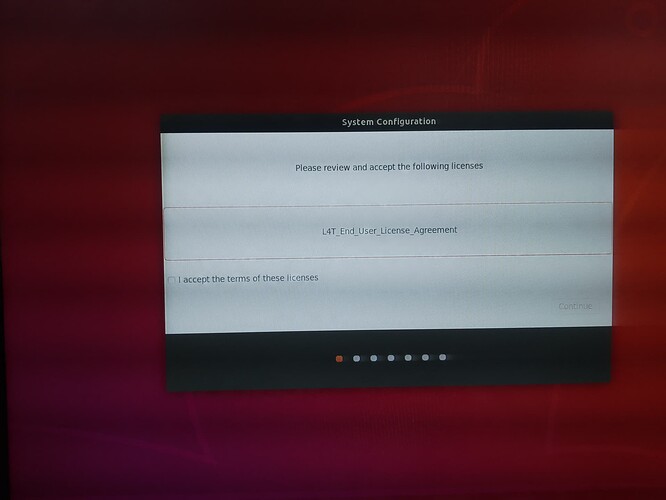

    now we are preparing for the coming mass production of our project. So, we want to increase efficiency, and help manufacture update FW more easily.
  • 3 issues:
    3.1 after we flashing a brand new tx2, when the device bring up at first time, we have to do system configuration, such as time zone, key board config, and account name and password, etc. We expect record all these information somewhere in the SDK, so that we can skip the system configuration, and all flashed devices are the same. We know that we can backup the system.img and flash to other devices, but this method cannot help our engineers to develop or release new FW, and it is complicated. So. we expect to modify and record the configurations to the SDK source code.
    3.2 now, we use the flash.sh script to flash brand new devices. the console log shows that lots of images are flashed to device, such as mbr.bin, dtb, system.img, etc. we expect to simplify by create a all in one image, so that we could flash only one imge to new device. the image include boot, apps, dtbs, etc.
    3.3 last but very inportant, how to flash several new devices at the same time?

Hi Henry Lou,
System configuration at first boot is also called oem-config. You could achieve this with the following instruction. Just do once l4t_create_default_user.sh for rootfs which is going to be flashed.
Flashing and Booting the Target Device - Skipping oem-config| NVIDIA Docs
If you want flash all in an image, it might take lots of time. Flash script includes partitioning your memory. You may try using command like dd to clone the disk.
You could refer to this. The README_Massflash.txt is included in Linux_for_Tegra/.
