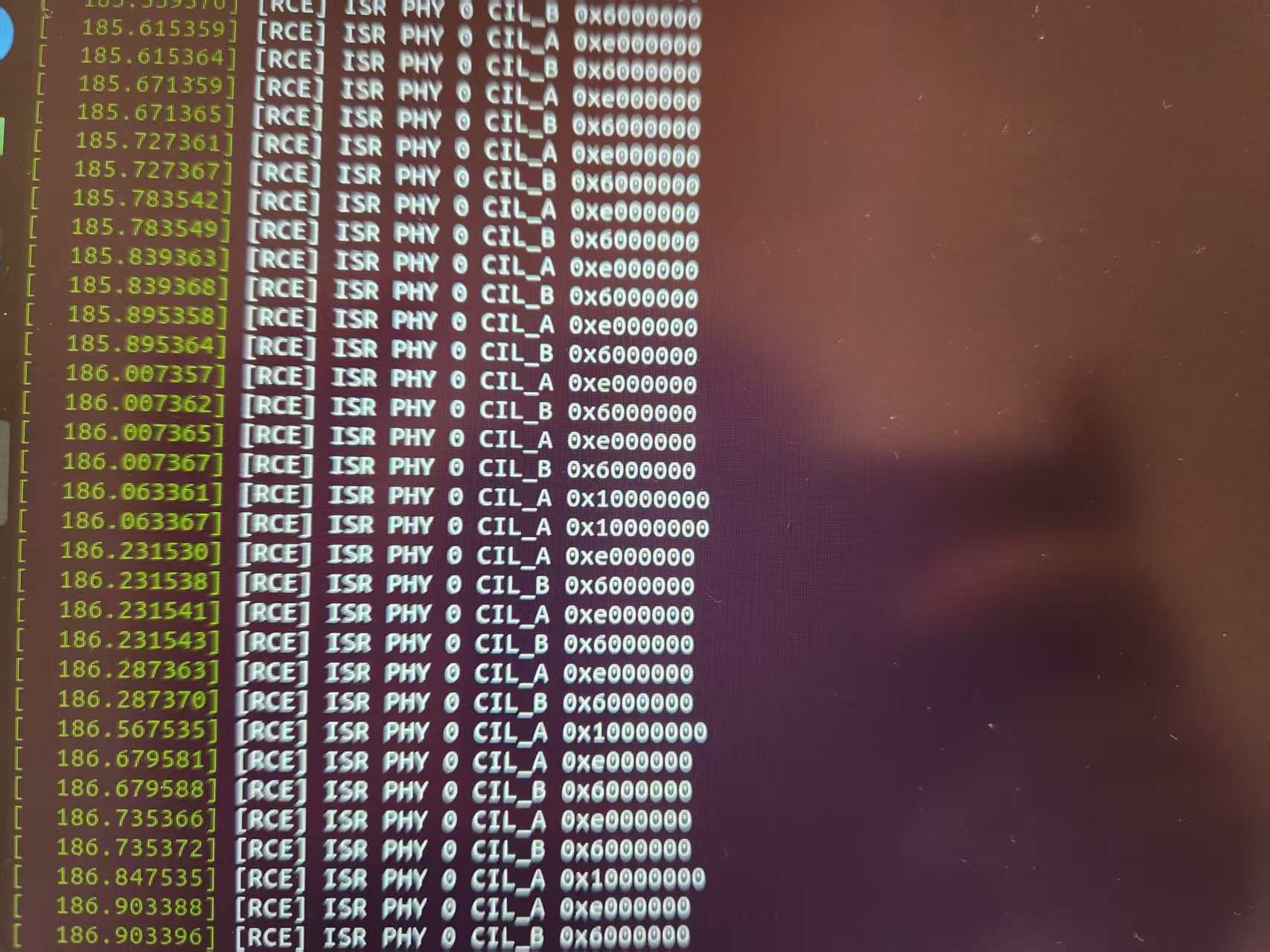

The msg show likes don’t have deskew, Is there a problem somewhere? I have already configured the sensor to send deskew signal everyframe, When I set MIPI 750M, I Get [RCE] ISR PHY 0 CIL_B 0x40 msg

It’s about deskew problem? 0x6/0xe000000 means deskew not completed, what’s about 0x10000000 means
0x10000000 means intr_dphy_cil_lane_align_err_a

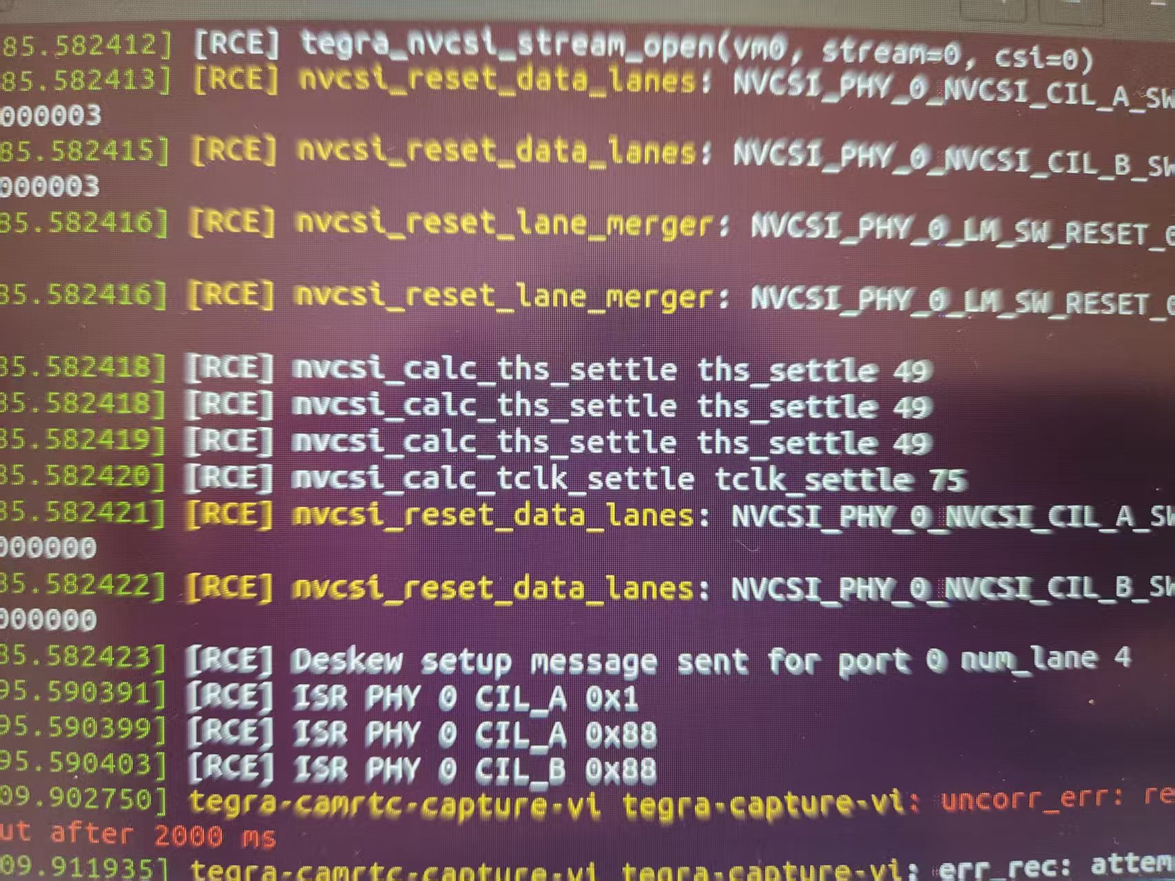

now the problem changed to the CIL_A 0x88, how to solve the problem
CIL_A 0x88 tell the data lane control error (err_intr_cil_data_lane_ctrl_err0_a). Could be the sensor lane configuration problem.

I have set sensor speed to 1.2Gbps with deskew signal.
I can successfully capture images,but dmesg logs show
[RCE] ISR PHY 0 CIL_A 0xe000000
[RCE] ISR PHY 0 CIL_B 0x6000000
I don’t know what the problem is. It’s sensor deskew signal error?
Is it a software issue or a board hardware issue?

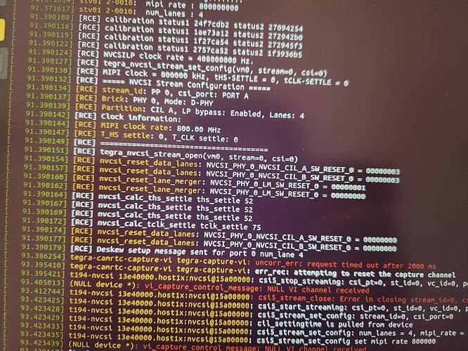

At 2.5Gbps, dmesg only show
[RCE] Deskew setup message sent for port 0 num_lane 4
then display
request timed out after 2500 ms
