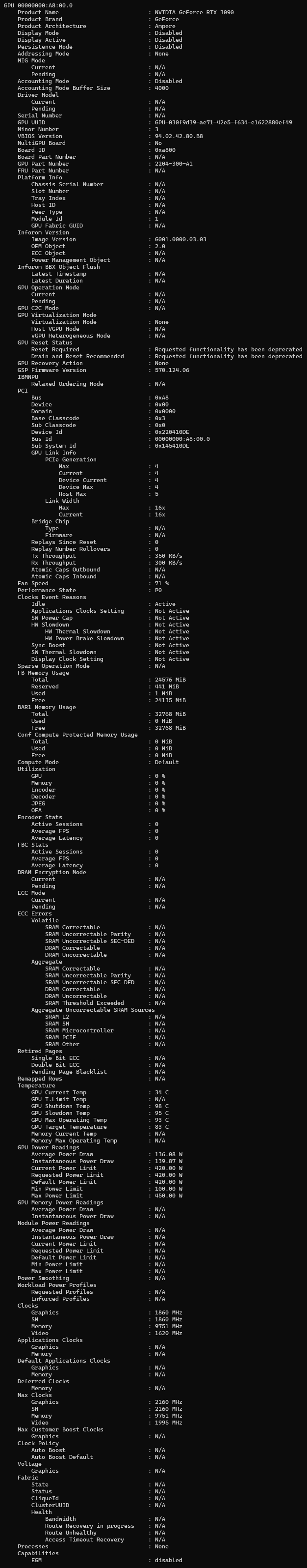

Here’s the details of my system for your reference:
  • Host system: Ubuntu 22.04 kernel version 5.15.0-135-generic.
  • Nvidia Driver Version: 570.124.06 (MIT/GPL kernel module)
  • CUDA Version: 12.8
  • GPU: Tesla V100 / RTX 3090
  • CPU: INTEL(R) XEON(R) GOLD 6530
Details of GPU:
  1. Tesla V100:
  1. RTX 3090:
I am looking forward for your advices. Any advice or insight is valued. Thanks a lot.
