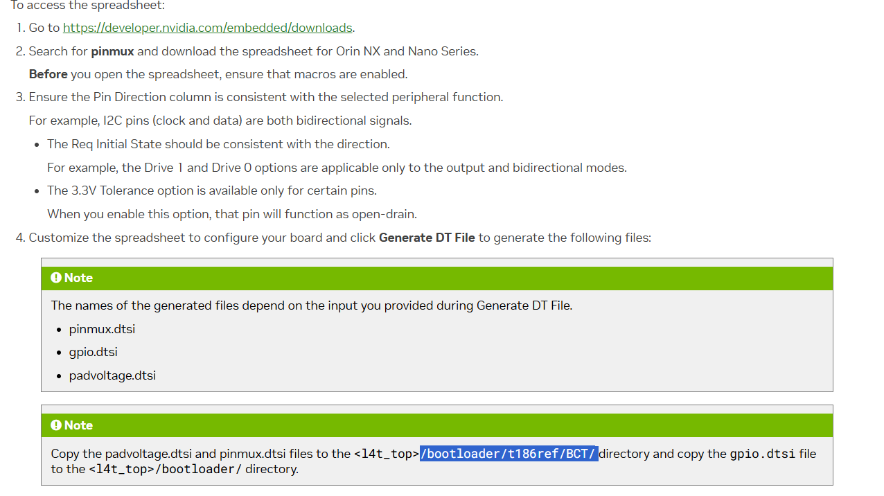

You should follow this to generate the dtsi and replace that file in your x86 host PC Linux_for_Tegra/bootloader/t186ref/BCT/.
Pinmux dts is not part of kernel dtb so you should not attach the kernel dtb file here. What I mean is the file you attached is not related.
Yes, accoriding to this I put pinmux and padvoltage dtsi files in /Linux_for_Tegra/bootloader/t186ref/BCT and gpio dtsi file into /Linux_for_Tegra/bootloader/.

GPIO.dtsi is included in the pinmux.dtsi.
You could read the default file first if you don’t understand what I mean.

Are you sure this line in your pinmux file could be correctly located?
#include "./Orin-jetson-orin-nx-series-dp-a03-gpio-default.dtsi"
I figured , I put it in /Linux_for_tegra/ but not in /Linux_for_tegra/bootloader/. Now there is not error in flashing. But have it made any changes in system device tree ?

As I already mentioned before, pinmux does not handle in the kernel device tree directly. You don’t need to care about it at all.
