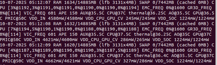

Did you convert the model to FP16?
Could you check GPU utilization with tegrastats?
$ sudo tegrastats
It’s common that the pre-processing or post-processing, which run on CPU, takes long time to finish.
To solve this, it’s recommended to run YOLO with Deepstream:
Thank you.
yes I did:
/usr/src/tensorrt/bin/trtexec --onnx=model.onnx --saveEngine=model.engine --fp16
now it is:
Thank you!
Okay, I’ll use DeepStream.
I used this command:
$ sudo tegrastats
Are there other ways to increase Jetson’s speed or FPS?
