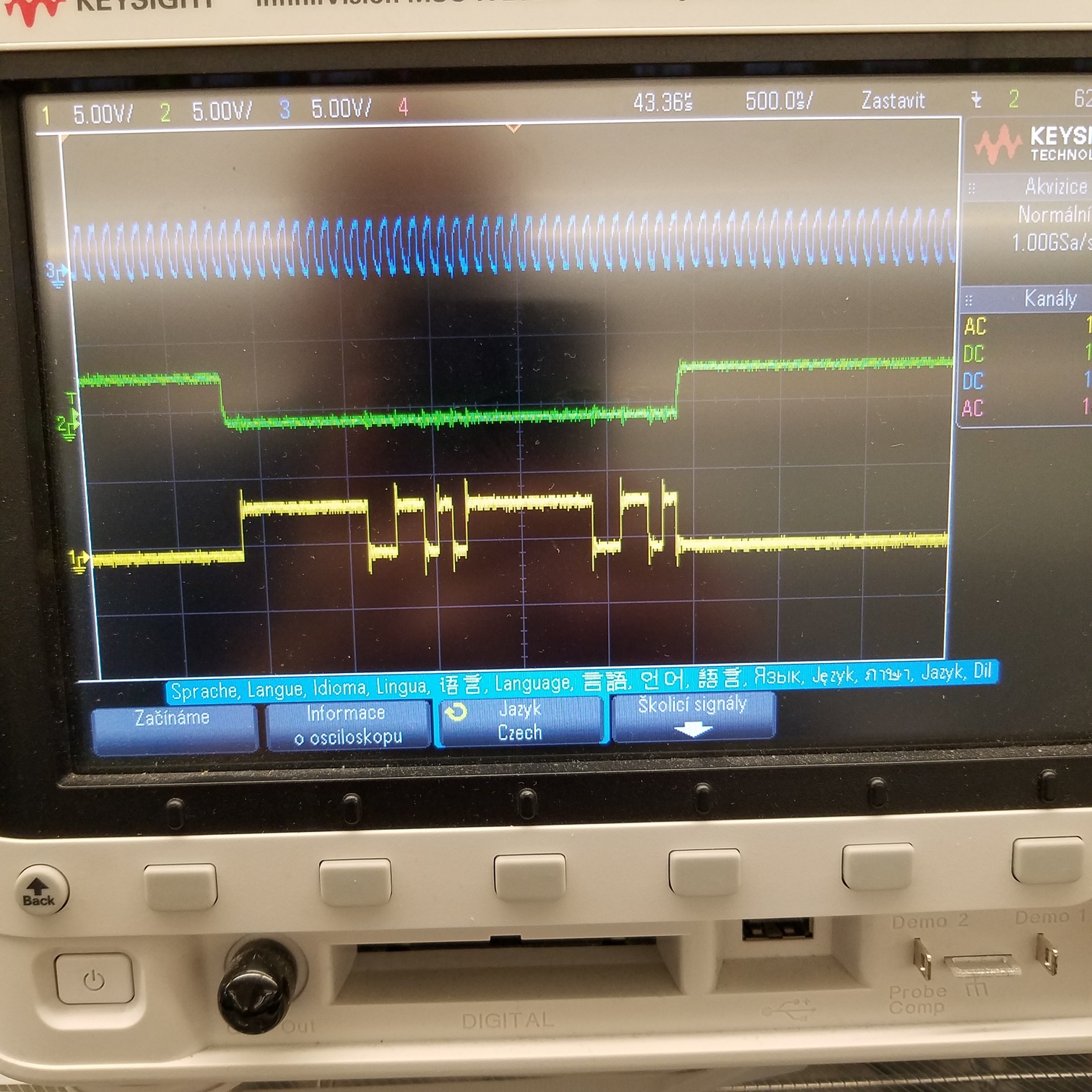

My scope displayed clearly two “chunks” (channels) instead of 6 channels in a TDM frame on I2S1 dout line. My capture command is

Attached is also the screen shot of the I2S1, and you can see only 2 channels are on the dout. The wav file was attached earlier in this thread. Let me know if you can find anything. Thanks again.

Hi Jin,
Looking at the I2S configuration, it appears to be configured for 8 channels and not 6. What does the following command show …
file /root/n51441.wav
The I2S configuration shows that there are 32-bits for the frame-sync. Do you see 32-bits of data on dout? I am wondering if you are only seeing 1 channel on dout and not two.

Jon,
I have
root@nvidia:~#     file /root/n51441.wav
/root/n51441.wav: RIFF (little-endian) data, WAVE audio, 6 channels 44100 Hz
I see 32 bits for the f-sync and I see two channels, each 16 bits. See the attached zoom-in scope shot. I confirmed that by playing a single channel wav, which only occupy half of the f-sync.
Hi Jin,
I think that the problem is mostly likely because you are using the ‘nvidia,tegra-audio-t186ref-p2382’ driver. For L4T we do all the validation with the ‘nvidia,tegra-audio-t186ref-mobile-rt565x’ machine driver. I believe that because you are using driver and you have 8 channels specified in the device-tree file it is using 8 channels (which is what I see in the I2S registers). So I recommend that you use the ‘nvidia,tegra-audio-t186ref-mobile-rt565x’ driver.
What version of L4T are you using? The frame-sync appears to be inverted which indicates that you may not have the latest L4T release for TX2 which is rel28.2. I recommend that you use this version as well.
