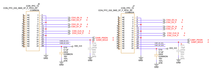

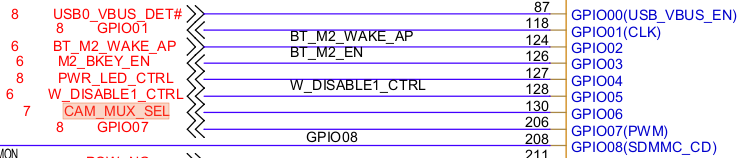

I have a custom board powered on TX2-NX which has 2 MIPI camera port. When connect 2 camera at same time, I can read images from either one camera by the following command:
gst-launch-1.0 nvarguscamerasrc sensor-id=0 ! 'video/x-raw(memory:NVMM), width=30, height=30, format=NV12, framerate=30/1' ! nvoverlaysink -e
I want to read the images from both 2 camera simultaneously. However, when I start the second camera after the first one is running, it turn an error:
This is the diagram of the multiplexer of the camera switch:
The diagram of CAM_MUX_SEL output pin from TX2-NX module:
The diagram of CSI signal which transport from MIPI port:
Selection_047
The diagram of two MIPI Camera:
Can someone tell me how to read the images from two camera device simultaneously?

Using xvimagesink instead of nvoverlaysink like below.
gst-launch-1.0 nvarguscamerasrc sensor-id=0 ! 'video/x-raw(memory:NVMM), width=30, height=30, format=NV12, framerate=30/1' ! nvvidconv ! xvimagesink -e
