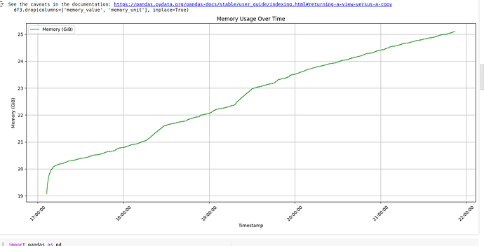

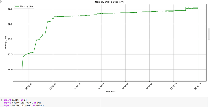

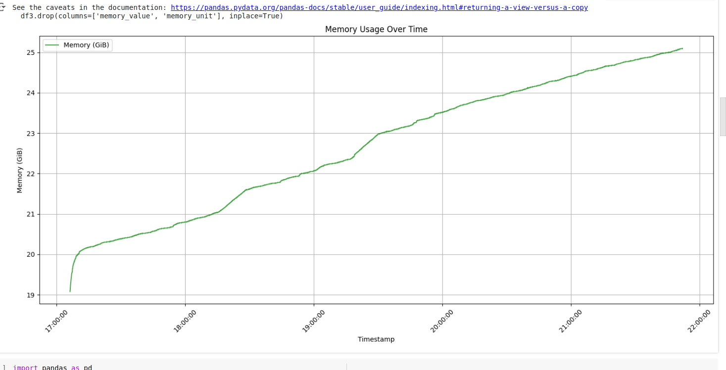

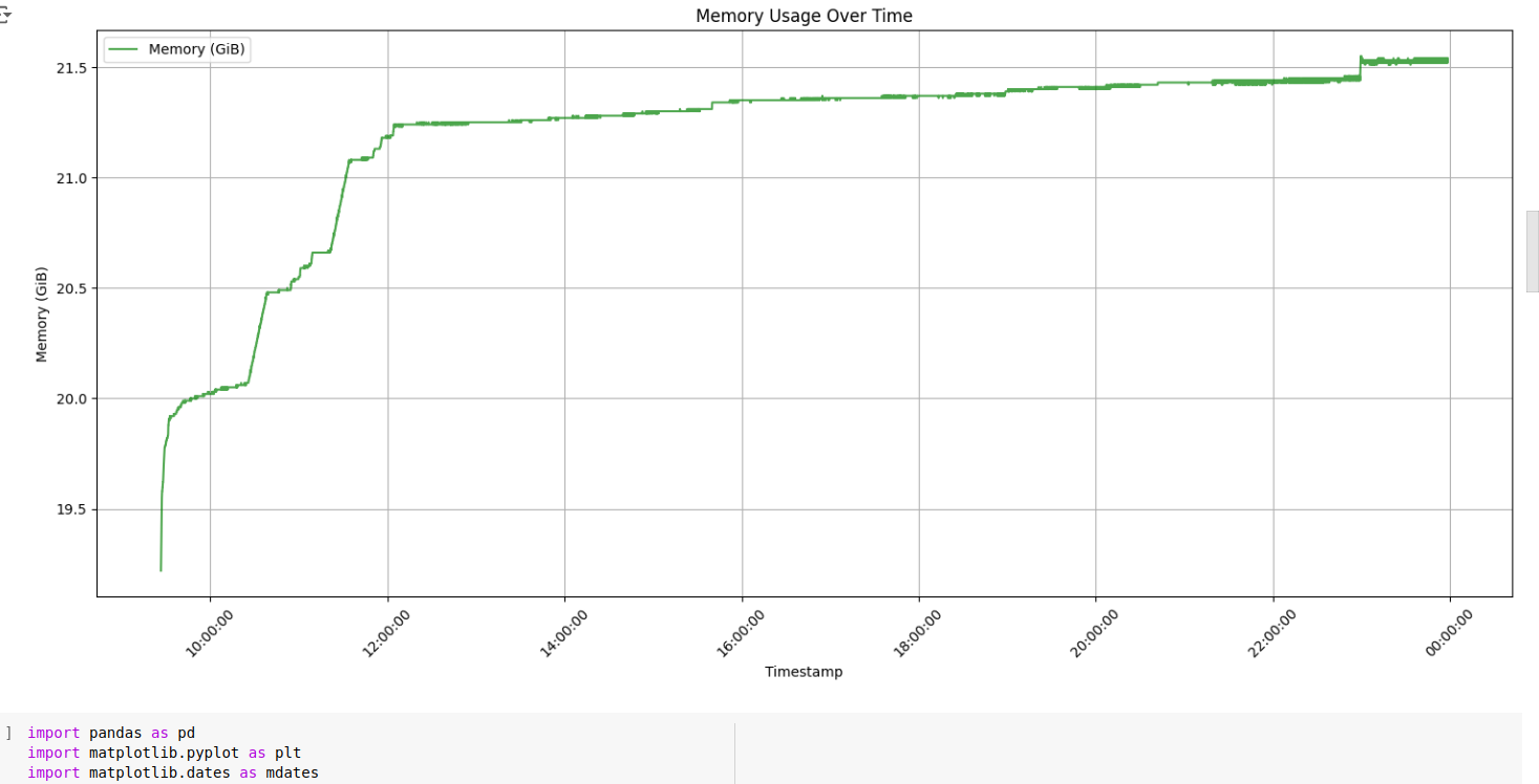

  2. The moment I give start-sr signal for recording, the memory leak is happening. If I dont give start-sr signal, there is no leak. I will attach the with and without recording memory graphs below.
    following is the memory graph when I dont give start-sr signal for recording and the memory leak is less.
following is the graph when I give start-sr signal for recording and the huge memory is leaking
  1. once video is recorded, we are renaming it with our custom name and throwing below error.
    Error   no video stream found
    Do you think leak is happening because of this?

1.Currently, setting the recorded file name is not supported. So you need to rename the file
2.How do you collect this data?
You also can monitor the memory usage if the issue caused by mem leak. please refer to DeepStream SDK FAQ - Intelligent Video Analytics / DeepStream SDK - NVIDIA Developer Forums , the script is for Jetson, but you can just have your attention on software memory usage if you are on dGPU. for dGPU, hardware memory usage, you can check nvidia-smi -l 1
3.Please wait for the sr-done signal to determine the end of recording. The usage is show in the FAQ.
