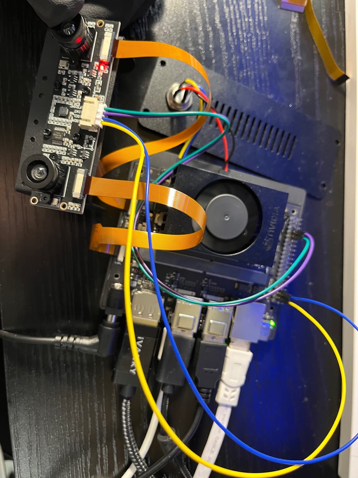

Hi, I just bought a stereo camera for my jetson to build some computer vision projects. However, I have no idea why I can’t connect my camera to jetson. I tried to connect through CSI like in the picture above but the Jetson can’t find any device connect to it. Can someone tell me if I connected the camera wrong, or do I have to set up any driver for it? Thank you
Run the jetson-io to enable dual imx219 to try.
Thank you, it works now.
