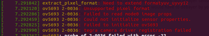

I want to get YUV420/RGB888 format video.
Here’s my changed Device Tree file.
Is it wrong?
mode0 { // OV5693_MODE_2592X1944
mclk_khz = "24000";//?
num_lanes = "4";//?
tegra_sinterface = "serial_e";//?
phy_mode = "CPHY";//?
discontinuous_clk = "no";//?
dpcm_enable = "false";//?
cil_settletime = "0";//?
active_w = "2592";//
active_h = "1944";//
mode_type = "yuv";
pixel_phase = "uyvy";//?
csi_pixel_bit_depth = "12";//The sensor readout pixel pattern
readout_orientation = "0";//
line_length = "2592";//
inherent_gain = "1";//
mclk_multiplier = "6.67";//
But when I reflash Xavier found
Then I use $dmesg
got
What should I do next?
The csi_pixel_bit_depth should be 16 for YUV422 input.

After reflash Xavier, I can get /dev/video0
And I try to get YUV420 data by using below command:
v4l2-ctl -d /dev/video0 --set-fmt-video=width=2592,height=1944,pixelformat=YU12 --set-ctrl bypass_mode=0 --stream-mmap --stream-count=1 --stream-to=yu12.raw
Then I v4l2-ctl --all
But Pixel Format didn’t change… It still ‘UYVY’
Please confirm what the sensor output format? Usually the pixel format report as UYVY/VYUY/… for YUV sensor.
