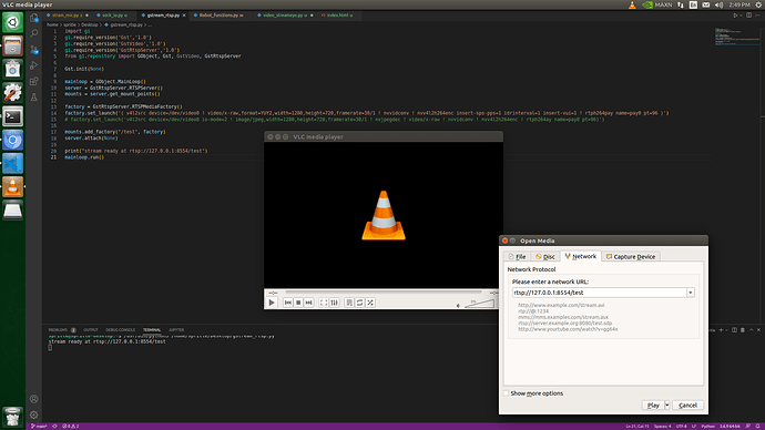

Thanks for you’re time, I ran this code and tried to open the RTSP URL in vlc player the console displays ā€œopening in BLOCKING MODEā€ . i am using Logitech 270 webcamera.

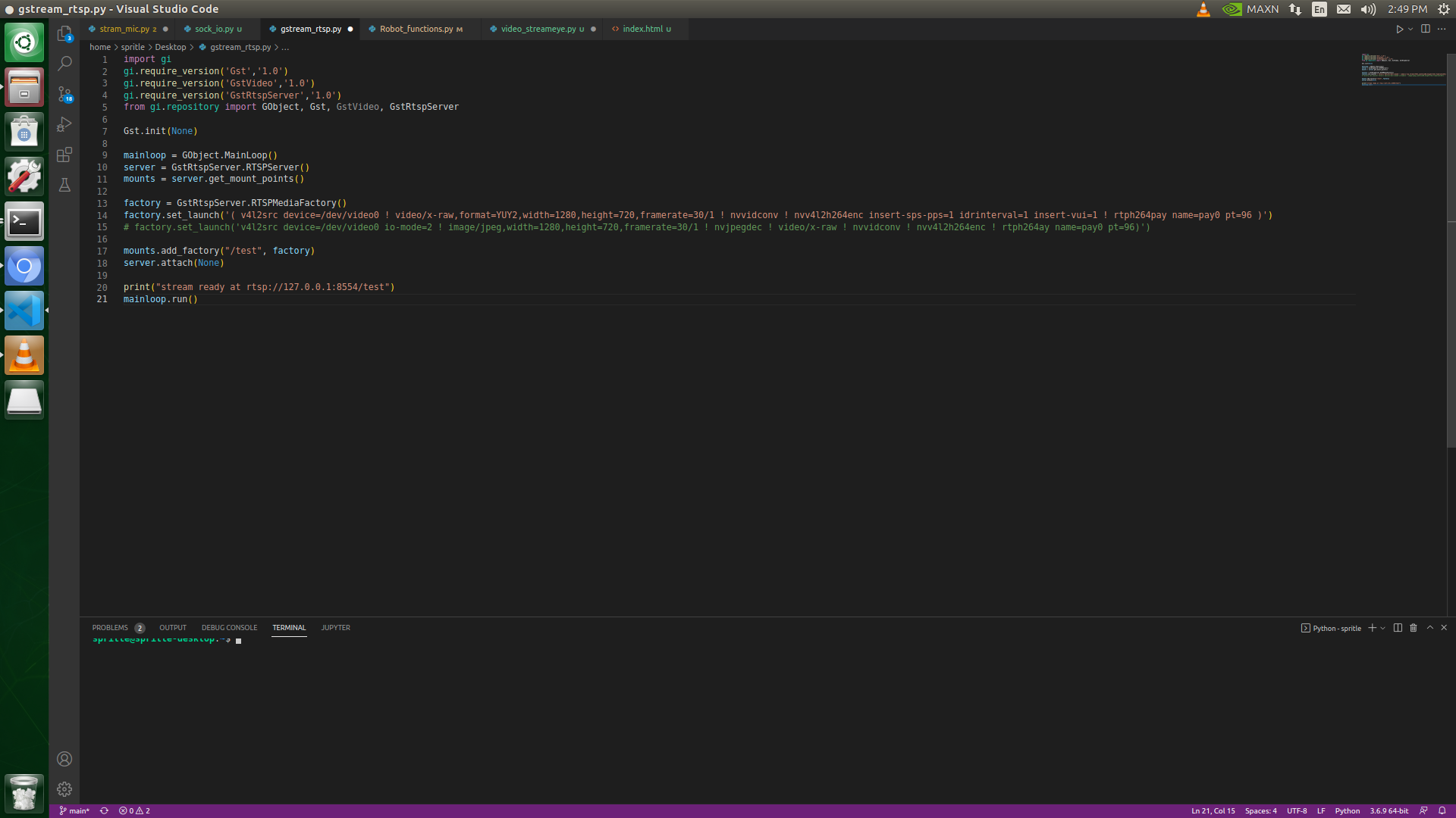

i can preview camera using this command - gst-launch-1.0 -v v4l2src device=/dev/video0 ! videoconvert ! xvimagesink
import gi
gi.require_version(ā€˜Gst’,ā€˜1.0’)
gi.require_version(ā€˜GstVideo’,ā€˜1.0’)
gi.require_version(ā€˜GstRtspServer’,ā€˜1.0’)
from gi.repository import GObject, Gst, GstVideo, GstRtspServer
Gst.init(None)
mainloop = GObject.MainLoop()
server = GstRtspServer.RTSPServer()
mounts = server.get_mount_points()
factory = GstRtspServer.RTSPMediaFactory()
factory.set_launch(ā€˜( v4l2src device=/dev/video0 ! video/x-raw,format=YUY2,width=1280,height=720,framerate=30/1 ! nvvidconv ! nvv4l2h264enc insert-sps-pps=1 idrinterval=1 insert-vui=1 ! rtph264pay name=pay0 pt=96 )’)
factory.set_launch(ā€˜v4l2src device=/dev/video0 io-mode=2 ! image/jpeg,width=1280,height=720,framerate=30/1 ! nvjpegdec ! video/x-raw ! nvvidconv ! nvv4l2h264enc ! rtph264ay name=pay0 pt=96)’)
mounts.add_factory(ā€œ/testā€, factory)
server.attach(None)
print(ā€œstream ready at rtsp://127.0.0.1:8554/testā€)
mainloop.run()

Ans: when run your code then try to open the URL on the vlc it automatically closed,so i am used OpenCV to capture the frame that the image coming corrupted.
can you please make me the pipeline,i tried to make pipeline but not working
Note that with Jetson, you would have to disable a VLC plugin, OMXIL.
Also note about corrupted frames that first 10 seconds may be trying to adjust.
You may also check with gstreamer:
gst-play-1.0 rtsp://127.0.0.1:8554/test
If this doesn’t correctly display the stream after 10 or 15s with videotestsrc, there is a problem with your system or software.

Hello Honey_Patouceul,
Thank you so much for helping !!!
This pipeline works after the vlc plugin is fixed, I am able to stream video over the local network.
