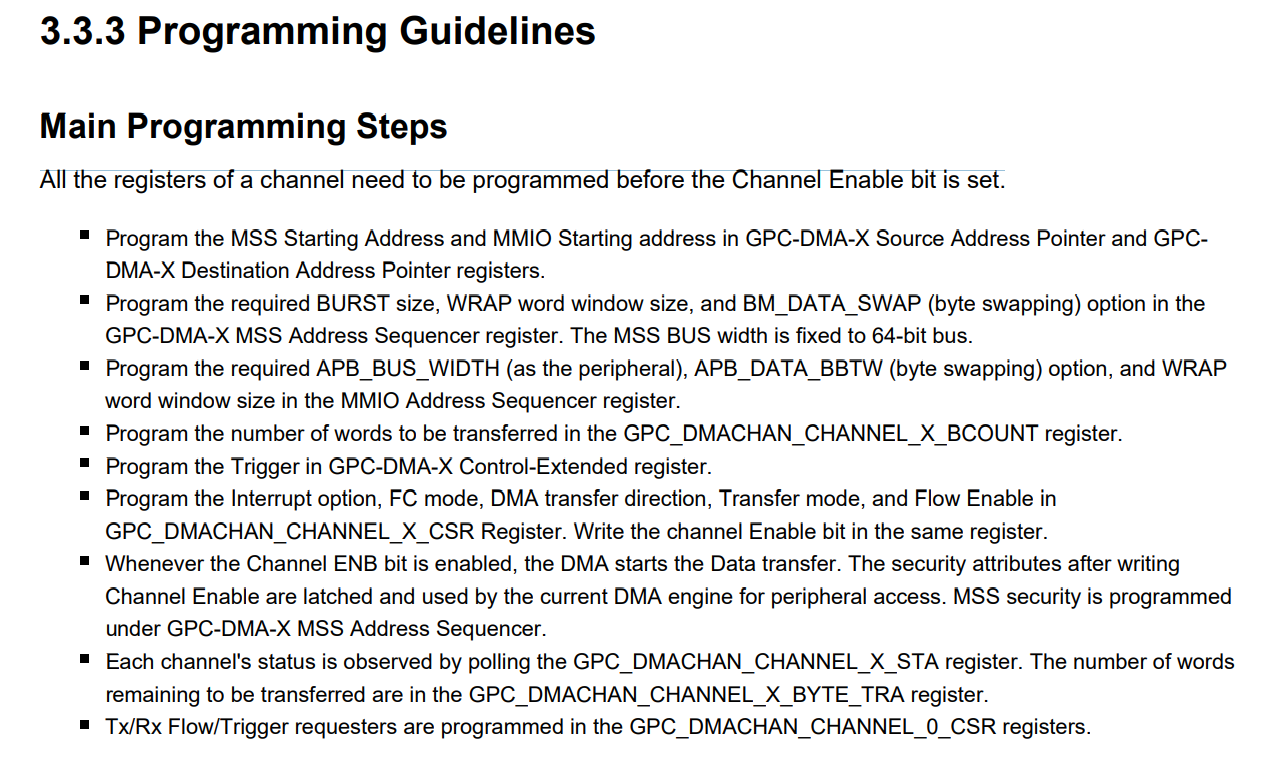

Hi. I am attempting to use DMA to receive PCIe data on NVIDIA AGX Xavier end point. I have two Jetson AGX Xaviers, one acting as root port, and the other acting as end point.
I can send data between the two using the method given in this guide:
https://docs.nvidia.com/jetson/archives/r35.2.1/DeveloperGuide/text/SD/Communications/PcieEndpointMode.html
However, I need max throughput for PCIe, which is why I need to use DMA. For that, I read the Xavier technical reference manual. In there, I found the following guidelines for programming DMA on page 110:
Based on this, I used the following sequence of data writes to program DMA channel 1 on end point (attempting to program channel 0 resulted in kernel panic).
busybox devmem 0x0262000C 32 0x3a040000    // source address
busybox devmem 0x02620010 32 0x80000000    // destination address
busybox devmem 0x02620018 32 0x03800000    // burst-size 16 words, no word wrap, no byte swap
busybox devmem 0x0262001C 32 0x2780007f    // peripheral (PCIe) bus-width (32-bit wide), no byte-swap, no word wrap, and burst size 16 words
busybox devmem 0x02620020 32 0x00000400    // data length (0x400 words = 4kB data)
busybox devmem 0x02620008 32 0x0002C000    // No idea what this does. Just selected channel 1 here
busybox devmem 0x02620000 32 0x09208400    // program the control register: disable all interrupts (need to focus only on DMA, will integrate interrupts later), use fully coherent, MMIO to Mem mode.
busybox devmem 0x02620000 32 0x89208400    // enable the DMA transfer
Here, I set the destination address randomly, and the took the source address from the PCIE_C5_32BIT_DMA entry on page 70 of the technical reference manual (not sure whether this is correct or not).
When I send data from root port to end point, I dont see any data at address 0x80000000 (which is my destination address).
What am I doing wrong? I am new to this, and am not sure whether the above process is correct or not, so any help would be appreciated.
Regards,
Sana Ur Rehman
How about you directly read the driver code mentioned in PCIe Endpint mode document…?
We already provided sample code for how to use DMA function. Not sure why you still program the DMA controller register by yourself…
