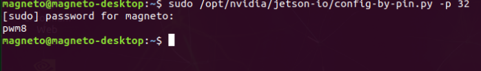

Update:
When I use the command line I get:
It’s really strange honestly. After checking this I checked using jetson.io and it also says pwm8. Then I rebooted to check and jetson.io will show me ‘gp’ again. I then used the command line and it shows me ‘pwm8’. So… maybe theres a problem here.
I can try some testing on pwm and see but I don’t feel confident in this output.

I found this in https://github.com/NVIDIA/jetson-gpio/blob/master/samples/test_all_apis.py
'JETSON_NX': {
    # Pre-test configuration, if boot-time pinmux doesn't set up PWM pins:
    # Set BOARD pin 32 as mux function PWM (func 1):
    # busybox devmem 0x2430040 32 0x401
    # Set BOARD pin 33 as mux function PWM (func 2):
    # busybox devmem 0x2440020 32 0x402
    # Board mode pins
    'out_a': 32,
    'in_a': 31,
    'out_b': 29,
    'in_b': 26,
    'unimplemented_pins': (),
    # Other pin modes:
    'cvm_pin': 'GPIO09',
    'tegra_soc_pin': 'AUD_MCLK',
    'all_pwms': (32, 33),
I used the “sudo busybox devmem 0x2430040 32 0x401” command and now my servo moves as expected.
