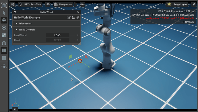

I got an error while running the import URDF tutorial (5.1.4. Importing URDF using Python)
I copied the code from the tutorial (5.1. Import URDF — Omniverse IsaacSim latest documentation) and pasted it to vscode, but an error occurred with the following screen.
How can I get the robot to follow the target like the video in the tutorial?
2024-01-07 10:33:34 [390,343ms] [Error] [asyncio] Task exception was never retrieved
future: <Task finished name='Task-692' coro=<BaseSampleExtension._on_load_world.<locals>._on_load_world_async() done, defined at c:/users/jeonghyoengyo/appdata/local/ov/pkg/isaac_sim-2023.1.1/exts/omni.isaac.examples/omni/isaac/examples/base_sample/base_sample_extension.py:152> exception=AttributeError("'NoneType' object has no attribute 'is_homogeneous'")>
  File "c:/users/jeonghyoengyo/appdata/local/ov/pkg/isaac_sim-2023.1.1/exts/omni.isaac.examples/omni/isaac/examples/base_sample/base_sample_extension.py", line 153, in _on_load_world_async
    await self._sample.load_world_async()
  File "c:/users/jeonghyoengyo/appdata/local/ov/pkg/isaac_sim-2023.1.1/exts/omni.isaac.examples/omni/isaac/examples/base_sample/base_sample.py", line 47, in load_world_async
    await self._world.reset_async()
  File "c:/users/jeonghyoengyo/appdata/local/ov/pkg/isaac_sim-2023.1.1/exts/omni.isaac.core/omni/isaac/core/world/world.py", line 520, in reset_async
    await self.reset_async_no_set_up_scene(soft=soft)
  File "c:/users/jeonghyoengyo/appdata/local/ov/pkg/isaac_sim-2023.1.1/exts/omni.isaac.core/omni/isaac/core/world/world.py", line 481, in reset_async_no_set_up_scene
    self._scene._finalize(self.physics_sim_view)
  File "c:/users/jeonghyoengyo/appdata/local/ov/pkg/isaac_sim-2023.1.1/exts/omni.isaac.core/omni/isaac/core/scenes/scene.py", line 322, in _finalize
    robot.initialize(physics_sim_view)
  File "c:/users/jeonghyoengyo/appdata/local/ov/pkg/isaac_sim-2023.1.1/exts/omni.isaac.franka/omni/isaac/franka/franka.py", line 118, in initialize
    super().initialize(physics_sim_view)
  File "c:/users/jeonghyoengyo/appdata/local/ov/pkg/isaac_sim-2023.1.1/exts/omni.isaac.core/omni/isaac/core/articulations/articulation.py", line 294, in initialize
    self._articulation_view.initialize(physics_sim_view=physics_sim_view)
  File "c:/users/jeonghyoengyo/appdata/local/ov/pkg/isaac_sim-2023.1.1/exts/omni.isaac.core/omni/isaac/core/articulations/articulation_view.py", line 349, in initialize
    assert self._physics_view.is_homogeneous
  File "c:/users/jeonghyoengyo/appdata/local/ov/pkg/isaac_sim-2023.1.1/extsphysics/omni.physics.tensors-105.1.12-5.1/omni/physics/tensors/impl/api.py", line 170, in is_homogeneous
    return self._backend.is_homogeneous
AttributeError: 'NoneType' object has no attribute 'is_homogeneous'
