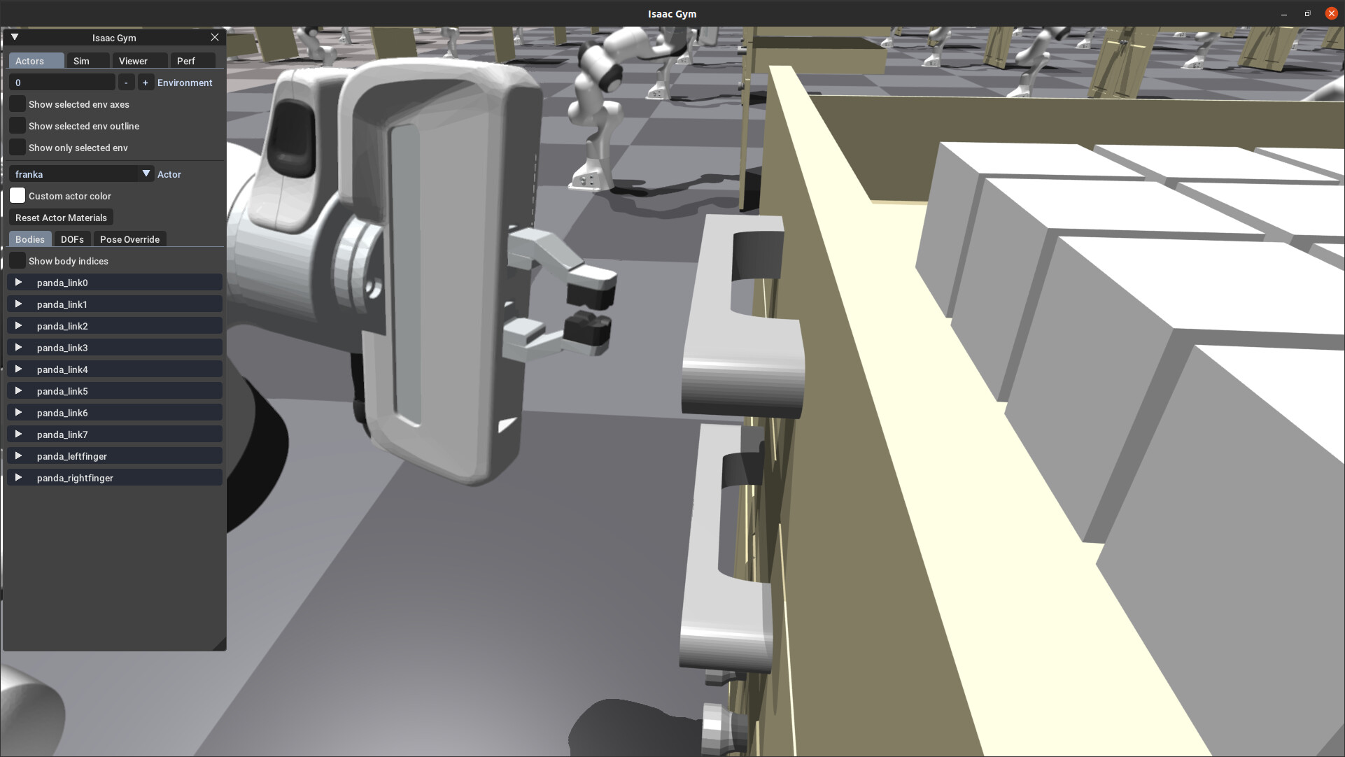

As a request, I would like to move the viewpoint between all “Envs” with the arrow keys and observe and compare them under the same conditions. I wish I could move the viewpoint to the next “Env” each time I press the arrow keys. I want the viewpoint in “Env” to be the same as the one in “Env” before moving. At this time, if the quantity of “Envs” is 10-30 or more, it is virtually impossible to move between all “Envs” by mouse for close observation. I don’t think there is much reason to display all “Envs”. I think it would be overwhelmingly efficient if the viewpoint could be moved with the arrow keys.

You can navigate through the scene by holding down the right mouse button to set the camera angle, and then using the WASD keys to move around.

Hi
I tried it, but it’s a little different.
For example, every time I press the arrow key once, I want to move to the next environment one after another fast as shown below.

Hi @DDPG7
You can look at the projectiles.py example to see how to read the keyboard and generate events using the subscribe_viewer_keyboard_event function. You will probably need to do some work in the Isaac Gym Envs frameworks to support this.
