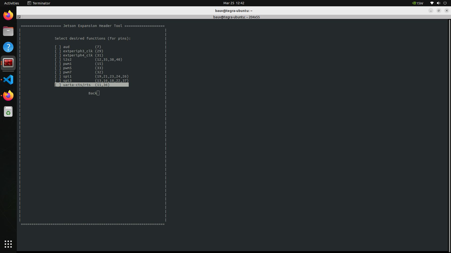

The Jetson-IO tool doesn’t show options for I2C to configure and the pin configuration shows pins 3 and 5 as i2c8 and pins 27 and 28 as i2c2.
