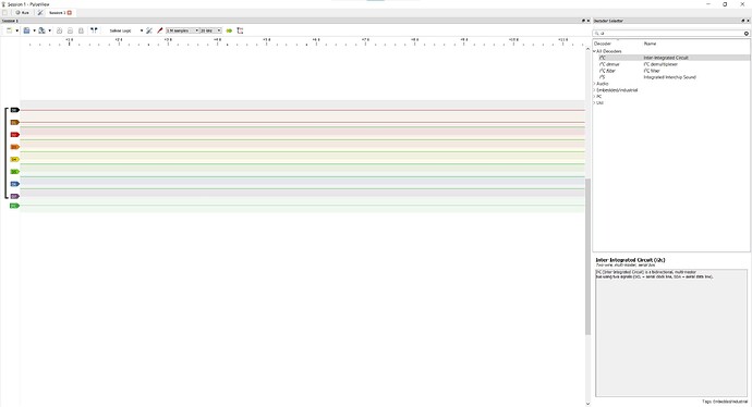

We’ve got a logic analyzer in and checked both i2c Bus 7 and Bus 1. We’re able to see and decode i2c traffic (from i2cdetect) on Bus 1, but Bus 7 appears to be giving out <1V and not signaling when using i2cdetect.

Please check why I2C bus 7 is not showing correct voltage levels. Common issues to check for are voltage incompatibility between the I2C bus on the module and on the sensor/device. Any voltage translators used on the I2C bus? Check the pull-up resistors are used on I2C SCL and SDA lines on both sides of the voltage translator/level shifter, if used and fine tune them, if needed to meet I2C specifications. Capture scope shots to verify the signal voltage levels and and timing.
@sgursal We’re not using any voltage translators on the i2c bus. The above pictures in the previous message were also performed with no external devices on the i2c bus 1 or 7.
Bus 7 had no devices at the time we probed and i2cdetect slowly prints out each entry with a - and generates “I2C transfer timed out” with every attempt. We get 0V from SDA / SCL.
Bus 1 appears to have internal i2c devices taken by the Jetson itself, and works fine with correct voltages and traffic on the i2c bus. Bus 1 has the correct voltage level and signals correctly with the internal i2c devices and our external i2c sensors (with pull-up resistors).

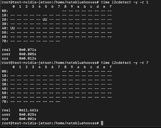

Here is output from i2cdetect on both buses along with time the operation took:
We are currently using the Jetson Orin Nano Super Developer Kit with the NVIDIA provided carrier board. The I2C device connected doesn’t initially show up in i2cdetect, but communicates correctly via Bus 1, but no communication via Bus 7 and we still get 0V probe.
