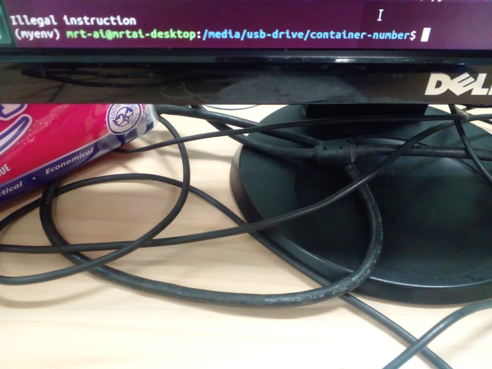

I get an illegal instruction error (without core dumped).
I tried to run python -c ‘import numpy’,
python -c ‘import torch’,
python -c ‘import torchvision’,
python -c ‘import cv2’
I already export OPENBLAS_CORETYPE=ARMV8
everything runs normally without error, but when going to run the model(image_path) , there is an illegal instruction error

Do you use Ultralytics frameworks to run YOLOv8?
If yes, please check if your PyTorch has CUDA enabled.
yes i use ultralytics framework, from pip install ultralytics.
my torch=2.1.2 and torchvision=0.16.2
after downgrade torch=1.12.0 and torchvision==0.13.0 and succes to run yolo,
but torch cuda still disabled.
Does this affect Yolo’s performance (detection time) when detecting images?
what version of torch and torchvision is compatible with cuda10.2?
You can find the package with CUDA enabled in the below document:
Please note that we only provide prebuilt for the default Python version.
For JetPack 4, it is Python 3.6.
