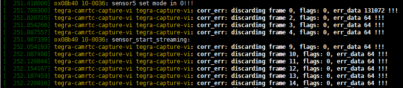

In version R36.2, there were some issues with the ORIN NANO lighting up the mipi camera OX08B40
Hi NV:
While using ORIN NANO to light up the mipi camera OX08B40, I found that I was able to preview the image directly using argus_camera, as shown below:
However, when I used v4l2-CTL to print the frame rate, I found that v4l2 couldn’t grab the stream. The following commands are used:
v4l2-ctl --verbose --set-fmt-video=width=3840,height=2160 --set-ctrl bypass_mode=0,sensor_mode=0 --stream-mmap -d /dev/video1
The printed information is as follows:

The dmesg information is as follows:
[   72.538325] ox08b40 9-0036: probing v4l2 sensor at addr 0x36
[   72.538447] ox08b40 9-0036: mclk name not present, assume sensor driven externally
[   72.538453] ox08b40 9-0036: avdd, iovdd and/or dvdd reglrs. not present, assume sensor powered independently
[   72.538662] ox08b40 9-0036: tegracam sensor driver:ox08b40_0_v2.0.6
[   72.538731] tegra-camrtc-capture-vi tegra-capture-vi: subdev ox08b40 9-0036 bound
[   72.539327] ox08b40 9-0036: sensor_power_on: power on
[   72.543610] ox08b40 9-0036: sensor_open:
[   72.645398] ox08b40 9-0036: detected ox08b40_0 sensor
[   72.645750] ox08b40 10-0036: probing v4l2 sensor at addr 0x36
[   72.645850] ox08b40 10-0036: mclk name not present, assume sensor driven externally
[   72.645854] ox08b40 10-0036: avdd, iovdd and/or dvdd reglrs. not present, assume sensor powered independently
[   72.645942] ox08b40 10-0036: tegracam sensor driver:ox08b40_1_v2.0.6
[   72.646023] tegra-camrtc-capture-vi tegra-capture-vi: subdev ox08b40 10-0036 bound
[   72.646903] ox08b40 10-0036: sensor_power_on: power on
[   72.651684] ox08b40 10-0036: sensor_open:
[   72.753445] ox08b40 10-0036: detected ox08b40_1 sensor
[   74.230131] start_addr=(0x20000), end_addr=(0x40000), buffer_size=(0x20000), smp_number_max=(16384)
[   74.894711] ox08b40 10-0036: sensor_power_on: power on
[   74.904071] ox08b40 10-0036: sensor5 set mode in 0!!!
[   75.306973] tegra-camrtc-capture-vi tegra-capture-vi: corr_err: discarding frame 1, flags: 0, err_data 64
[   75.340221] tegra-camrtc-capture-vi tegra-capture-vi: corr_err: discarding frame 2, flags: 0, err_data 64
[   75.373543] tegra-camrtc-capture-vi tegra-capture-vi: corr_err: discarding frame 3, flags: 0, err_data 64
[   75.406872] tegra-camrtc-capture-vi tegra-capture-vi: corr_err: discarding frame 4, flags: 0, err_data 64
[   75.473457] ox08b40 10-0036: sensor_start_streaming:
[   75.540205] tegra-camrtc-capture-vi tegra-capture-vi: corr_err: discarding frame 8, flags: 0, err_data 64
[   75.573471] tegra-camrtc-capture-vi tegra-capture-vi: corr_err: discarding frame 9, flags: 0, err_data 64
[   75.606820] tegra-camrtc-capture-vi tegra-capture-vi: corr_err: discarding frame 10, flags: 0, err_data 64
[   75.640118] tegra-camrtc-capture-vi tegra-capture-vi: corr_err: discarding frame 11, flags: 0, err_data 64
[   75.673445] tegra-camrtc-capture-vi tegra-capture-vi: corr_err: discarding frame 12, flags: 0, err_data 64
[   75.706764] tegra-camrtc-capture-vi tegra-capture-vi: corr_err: discarding frame 13, flags: 0, err_data 64
[   75.740087] tegra-camrtc-capture-vi tegra-capture-vi: corr_err: discarding frame 14, flags: 0, err_data 64
[   75.773421] tegra-camrtc-capture-vi tegra-capture-vi: corr_err: discarding frame 15, flags: 0, err_data 64
[   75.806737] tegra-camrtc-capture-vi tegra-capture-vi: corr_err: discarding frame 16, flags: 0, err_data 64
[   75.840050] tegra-camrtc-capture-vi tegra-capture-vi: corr_err: discarding frame 17, flags: 0, err_data 64
[   75.873471] tegra-camrtc-capture-vi tegra-capture-vi: corr_err: discarding frame 18, flags: 0, err_data 64
[   75.906744] tegra-camrtc-capture-vi tegra-capture-vi: corr_err: discarding frame 19, flags: 0, err_data 64
[   75.940096] tegra-camrtc-capture-vi tegra-capture-vi: corr_err: discarding frame 20, flags: 0, err_data 64
[   75.973395] tegra-camrtc-capture-vi tegra-capture-vi: corr_err: discarding frame 21, flags: 0, err_data 64
[   76.006689] tegra-camrtc-capture-vi tegra-capture-vi: corr_err: discarding frame 22, flags: 0, err_data 64
[   76.040033] tegra-camrtc-capture-vi tegra-capture-vi: corr_err: discarding frame 23, flags: 0, err_data 64
[   76.073364] tegra-camrtc-capture-vi tegra-capture-vi: corr_err: discarding frame 24, flags: 0, err_data 64
[   76.106661] tegra-camrtc-capture-vi tegra-capture-vi: corr_err: discarding frame 25, flags: 0, err_data 64
[   76.139969] tegra-camrtc-capture-vi tegra-capture-vi: corr_err: discarding frame 26, flags: 0, err_data 64
[   76.173281] tegra-camrtc-capture-vi tegra-capture-vi: corr_err: discarding frame 27, flags: 0, err_data 64
[   76.206635] tegra-camrtc-capture-vi tegra-capture-vi: corr_err: discarding frame 28, flags: 0, err_data 64
[   76.239929] tegra-camrtc-capture-vi tegra-capture-vi: corr_err: discarding frame 29, flags: 0, err_data 64
[   76.273269] tegra-camrtc-capture-vi tegra-capture-vi: corr_err: discarding frame 30, flags: 0, err_data 64
[   76.306854] tegra-camrtc-capture-vi tegra-capture-vi: corr_err: discarding frame 31, flags: 0, err_data 64
[   76.340157] tegra-camrtc-capture-vi tegra-capture-vi: corr_err: discarding frame 32, flags: 0, err_data 64
[   76.373203] tegra-camrtc-capture-vi tegra-capture-vi: corr_err: discarding frame 33, flags: 0, err_data 64
[   76.406612] tegra-camrtc-capture-vi tegra-capture-vi: corr_err: discarding frame 34, flags: 0, err_data 64
[   76.439851] tegra-camrtc-capture-vi tegra-capture-vi: corr_err: discarding frame 35, flags: 0, err_data 64
[   76.473173] tegra-camrtc-capture-vi tegra-capture-vi: corr_err: discarding frame 36, flags: 0, err_data 64
[   76.506537] tegra-camrtc-capture-vi tegra-capture-vi: corr_err: discarding frame 37, flags: 0, err_data 64
[   76.539826] tegra-camrtc-capture-vi tegra-capture-vi: corr_err: discarding frame 38, flags: 0, err_data 64
[   76.573130] tegra-camrtc-capture-vi tegra-capture-vi: corr_err: discarding frame 39, flags: 0, err_data 64
[   76.606520] tegra-camrtc-capture-vi tegra-capture-vi: corr_err: discarding frame 40, flags: 0, err_data 64
[   76.639800] tegra-camrtc-capture-vi tegra-capture-vi: corr_err: discarding frame 41, flags: 0, err_data 64
[   76.673120] tegra-camrtc-capture-vi tegra-capture-vi: corr_err: discarding frame 42, flags: 0, err_data 64
[   76.706679] tegra-camrtc-capture-vi tegra-capture-vi: corr_err: discarding frame 43, flags: 0, err_data 64
[   76.739773] tegra-camrtc-capture-vi tegra-capture-vi: corr_err: discarding frame 44, flags: 0, err_data 64
[   76.773096] tegra-camrtc-capture-vi tegra-capture-vi: corr_err: discarding frame 45, flags: 0, err_data 64
[   76.806657] tegra-camrtc-capture-vi tegra-capture-vi: corr_err: discarding frame 46, flags: 0, err_data 64
[   76.839774] tegra-camrtc-capture-vi tegra-capture-vi: corr_err: discarding frame 47, flags: 0, err_data 64
[   76.873321] tegra-camrtc-capture-vi tegra-capture-vi: corr_err: discarding frame 48, flags: 0, err_data 64
[   76.906368] tegra-camrtc-capture-vi tegra-capture-vi: corr_err: discarding frame 49, flags: 0, err_data 64
[   76.939668] tegra-camrtc-capture-vi tegra-capture-vi: corr_err: discarding frame 50, flags: 0, err_data 64
[   76.973014] tegra-camrtc-capture-vi tegra-capture-vi: corr_err: discarding frame 51, flags: 0, err_data 64
[   77.006315] tegra-camrtc-capture-vi tegra-capture-vi: corr_err: discarding frame 52, flags: 0, err_data 64
[   77.039733] tegra-camrtc-capture-vi tegra-capture-vi: corr_err: discarding frame 53, flags: 0, err_data 64
[   77.072994] tegra-camrtc-capture-vi tegra-capture-vi: corr_err: discarding frame 54, flags: 0, err_data 64
[   77.073027] ox08b40 10-0036: sensor_stop_streaming:
[   77.073825] ox08b40 10-0036: sensor_power_off: power off
I would like to ask how to make v4l2 get stream? Thank you very much for your help.

Could you modify the vi5_fops.c to try.
diff --git a/drivers/media/platform/tegra/camera/vi/vi5_fops.c b/drivers/media/platform/tegra/camera/vi/vi5_fops.c
index c1a44400e..7e7a365f9 100644
--- a/drivers/media/platform/tegra/camera/vi/vi5_fops.c
+++ b/drivers/media/platform/tegra/camera/vi/vi5_fops.c
@@ -538,12 +538,6 @@ static void vi5_capture_dequeue(struct tegra_channel *chan,
                                        "err_data %d\n",
                                        descr->status.frame_id, descr->status.flags,
                                        descr->status.err_data);
-#if LINUX_VERSION_CODE < KERNEL_VERSION(5, 4, 0)
-                                       buf->vb2_state = VB2_BUF_STATE_REQUEUEING;
-#else
-                                       buf->vb2_state = VB2_BUF_STATE_ERROR;
-#endif
-                       goto done;
                } else if (!vi_port) {
                        gang_prev_frame_id = descr->status.frame_id;
Yes, what should I change?
I have checked the vi5-fops.c file of version R36.2, is there anything that needs to be modified?
Could you modify the output string in the dev_warn to confirm applied the modification.
I added three at the end of the dev_warn string! . The dmesg log at this point is as follows:
Please get the trace log again.
