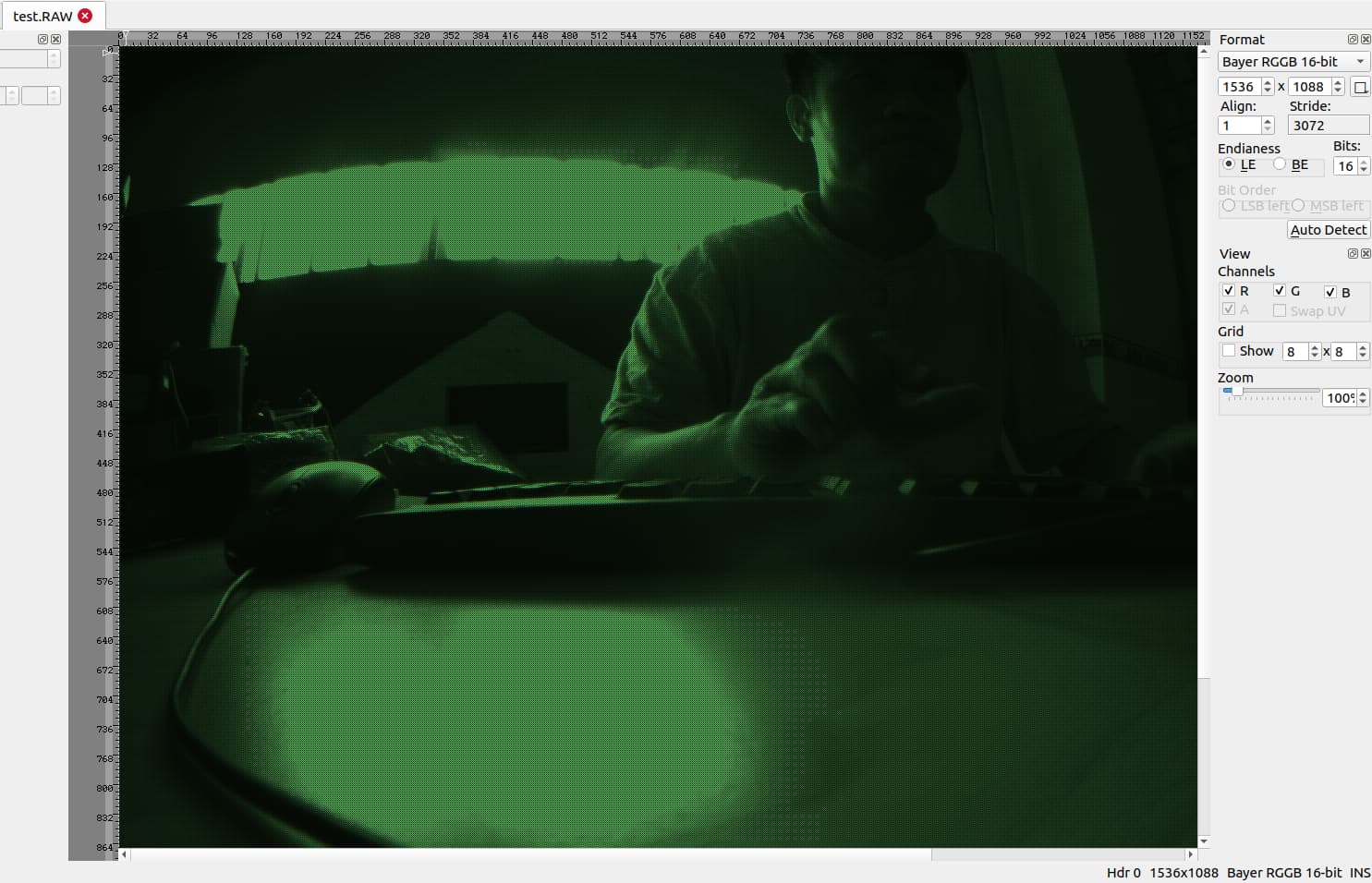

So far, the blocksize should be = 1456 * 1088 * 2 = 3168256, however it was 3342336 = 334233600/100 = 1536 * 1088 * 2.

Could you suggest why there’s difference in bytes per frame, please ?

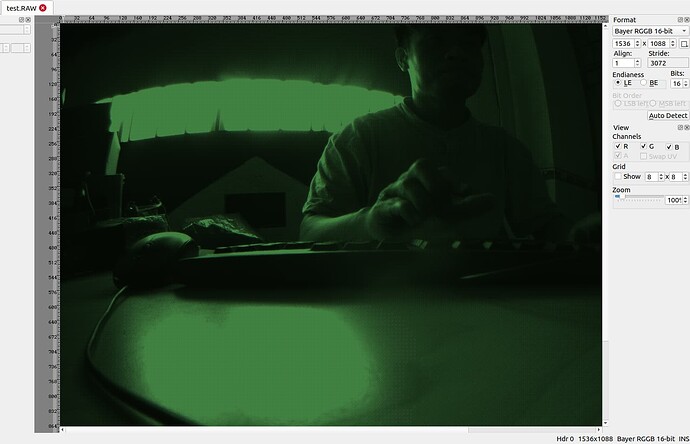

Hi again, I just found out that the 80 bytes (= 1536 - 1456) is actually the meta data of the sensor.
So it seem that I cannot use the gstreamer command (with format=GRAY16_LE) to re-stream the captured file.
To update, I was able to visualize the capture data with 7yuv tool using the temporary width =1536:
