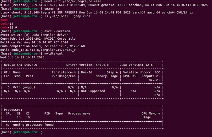

Hi everyone,
I just ran the test again on my Jetson Orin Nano and confirmed that gemma3:4b via Ollama responds consistently in under 10 seconds, even for vision-language prompts using images. You can see this in the attached screenshots showing both my environment and the execution time.
If you’re seeing much slower responses, here are a few suggestions to check and compare:
To reproduce my setup, please run the following commands and compare with the screenshot:
# Check JetPack / L4T version
head -n 1 /etc/nv_tegra_release
# Check kernel
uname -a
# Check CUDA version
nvcc --version
ls /usr/local | grep cuda
dpkg -l | grep cuda
# Check NVIDIA driver
nvidia-smi
# Check Ollama version
ollama --version
⚙️ Also verify:
# Power mode should be MAXN (25W)
sudo nvpmodel -q
sudo jetson_clocks
Make sure your power supply is strong enough, underpowered devices often throttle CPU/GPU and drastically affect inference time. At least 5V/4A is recommended for MAXN mode.
Let me know what you observe and feel free to share your own setup screenshot. Happy to help debug further.
Asier 👽
Thank you so much @Asier for the quick response!
Good News: I’m getting the similar result as yours after fixing my config.
In fact, the LD_LIBRARY_PATH in my .bashrc did not include CUDA/lib64when I installed Ollama using their script. Due to which, Ollama was installed without GPU configured… Up on correcting the LD_LIBRARY_PATH and re-installing Ollama, it worked perfectly as seen in your demo. Very impressive speed, indeed!
The debugging steps you have provided was very helpful. I started noticing the missing LD_LIBRARY_PATH when checked nvcc --version following your instruction. I’ve attached the log BEFORE the fix and hope it helps other in similar situation.
nvidia-log.txt (4.3 KB)
I should have also corrected the statement on GPU usage in my original report, because I was misled by jtop when running other (NOT Ollama) workloads. But I’m unable to edit it anymore. Sorry for the confusion.
Thank you again and thanks @AastaLLL too for the quick guidance!
