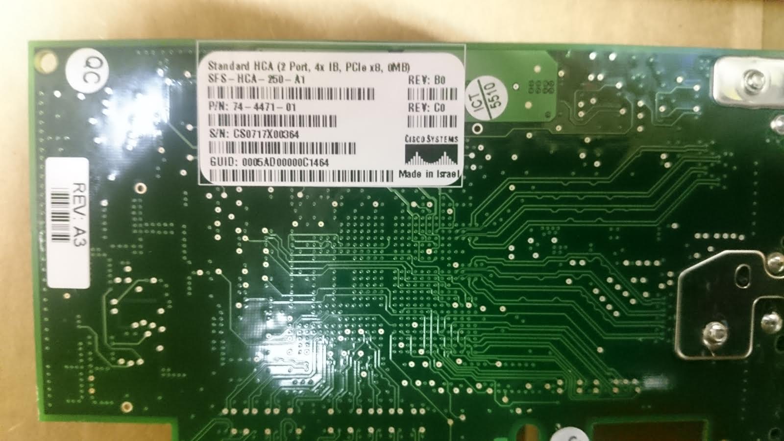

I really need some help here, I’m setting up a small cluster and decided instead of using 10gig ethernet I’ll play with infiniband
SO here I am at step one with 3 * Cisco SFS-HCA-250-A1 cards .( Mellanox Technologies MT25208 [InfiniHost III Ex] (rev a0) ) and 2 * Mellanox CX4 Infiniband Dual Port 10GB Network Card - MN: MHGA28-XTC .( Mellanox Technologies MT25208 [InfiniHost III Ex] (rev a20) )
It turns out all the cards are the same model as well as hardware revision of A3.
I’ve updated all the cards to firmware version 5.3.
My issue is that the Mellanox CX4’s are working perfectly but I cannot for the life of me get the Cisco Variants working. What is the difference between the 2 cards ultimately ? and what else do I ned to change on the Cisco branded cards to get them to work like their Mellanox C4 twins.
It cannot be anything else but hardware / firmware related as I can swop out cards from the cisco to the mellanox variant and everything works perfectly. When I run a query with mstflint I pretty much get the same result from both card variants as shown below besides those wiered “▒ڭ” symbols prefixing Board Id and VSD fields which are easily changed during a firmware update if required.

Here are pics of the back of each card just for sanity purposes.
mellanox cx4

Just to let everyone know and to close this one off I resolved the issue.
Originally I flashed both the Mellanox cx4 and the cisco variants with the same firmware for cards with PID MT_0370130002 using flint. After flashing all cards were are firmware verison 5.3. The Mellanox CX4’s worked but the Ciscos did not.
TO resolve it I used mlxburn with default 5.3 firmware and used a slightly different config file (I wont go into detail around this) to generate the .bin firmware file.
I then flashed the cards with flint using the new firmware and the cards are working now
I’ve attached a link the firmware to this thread if anyone ever needs it .
Dropbox - cisco-sfs_HCS_250_Infini.bin Dropbox - cisco-sfs_HCS_250_Infini.bin - Simplify your life
