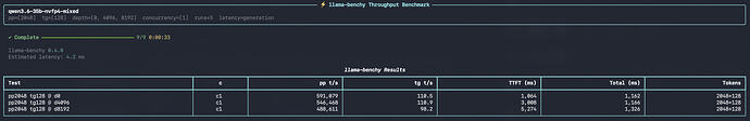

Here’s some notable performance stats:
NOTE: All tok/s numbers are single user, i.e. not aggregated.
(I’ll be doing aggregated numbers later what I find time.)
Single GB10:
Qweb3.6-27b-nvfp4-full ( i.e. 100% nvfp4 quant):
~40 tok/s
Qwen3.6-35B-A3B (nvfp4 full):
~110 tok/s
Qwen3.6-9B (nvfp4 full):
~80 tok/s
qwen3.5-0.8b-nvfp4-mixed:** ~227.8 tok/s**
qwen3.5-2b-nvfp4-mixed:** ~161.6 tok/s
qwen3.5-4b-nvfp4-mixed: ~100 tok/s
Two GB10s:
~45-50 tok/s
~120+ tok/s
~90-100 tok/s

Hi Stav,
cluster numbers look slower than current engines, but glad to see additional ways to run LLMs on these machines!
Thanks, I’d like if possible to see some apples for apples comparisons.
My quants are pure nvfp4 at the moment and I’m just starting with this, so looking for ways to improve.
I’m really curious, if you have a faster speed on 2x GB10 for the Qwen3.6 27b Dense model I’d love to see the recipe, maybe I’ll get something out of it and improve. The 27b is a big challenge!
Stav
I don’t know about 27B, but at least on 35B with NVFP4, I’m am getting the same token/s with regular eugr vllm at c=1 and higher at c=4,8,16
The other issue is that not all nvfp4 quant models are the same. If you want best quality, go for Thomas Autoround or PrismaAura .
yes JW but you’re comparing an MoE vs a Dense Model… apples meet oranges
fast I’ve been able to get on a 3.6 27B is 30 tk/s on a single user warm node
Sorry, my bad. I was comparing Apple to Pineapple.
Right now fresh download and install using the 0.8B I’m just getting output that is garbled !!!
I have not seen single node for the 27b at 40 t/s and certainly not a 50 t/s case 2x or otherwise. And this is c=1 which means aggregates are going to be higher.
DOH sorry my bad actually I was mis-reading your post as being comparing your 35B numbers to 27B :)
Hmm strange. do you have any output logs?
