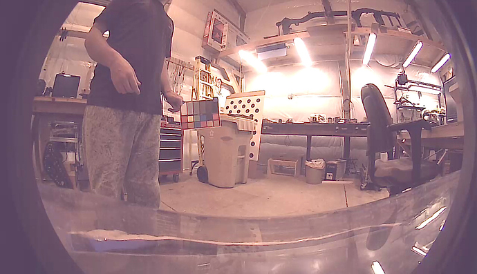

For some reason the ISP is producing washed out images for my sensor, and I want to figure out what i’m doing wrong.
External Media
External Media
The first image was taken raw with the following pipeline:
v4l2-ctl -d /dev/video0 --set-fmt-video=width=1280,height=720,pixelformat=RG12 --set-ctrl exposure=90000,bypass_mode=0 --stream-mmap --stream-count=1 --stream-to=test.raw
We then wrote a simple javascript debayer script to read in the raw and convert it to a png

The image looks great, it perfectly captures the cavernous interior of our warehouse.
However if I stream the image through the ISP, in this case going to VLC with auto-exposure turned off and manually setting the same exposure and gain values I get the second image which is super pink and washed out. The edges of objects also look really strange, developing thick pixely borders

Has anyone encountered this sort of behavior? Is it some problem with my device tree settings?
code: GitHub - Daxbot/daxc02: Nvidia Jetson TX1/TX2 Kernel Driver for Leopard Imaging LI-M021C-MIPI
hello Atrer,
since you’re developing new sensor driver on Jetson platform, you’ll need corresponding ISP tuning settings.
please also contact our preferred partners for ISP tuning support: [url]https://developer.nvidia.com/embedded/community/partners[/url]
thanks
I’ve contacted leopard, who makes our cameras.
In the meantime is there a default ISP tuning file located somewhere in the kernel I can work with? The image looks great with nothing but debayer, so basically I just want to turn off any tweaking that’s done.
