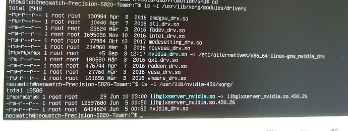

Really odd, still the same missing files. Please post the output of
ls -l /usr/lib/xorg/modules/drivers
and
ls -l /usr/lib/nvidia-430/xorg
The Output is attached to post #11
Ok, now I’m getting it, at least partially. Looks like the new driver packages do not really fit anymore correctly to the 16.04 version you’re running.
