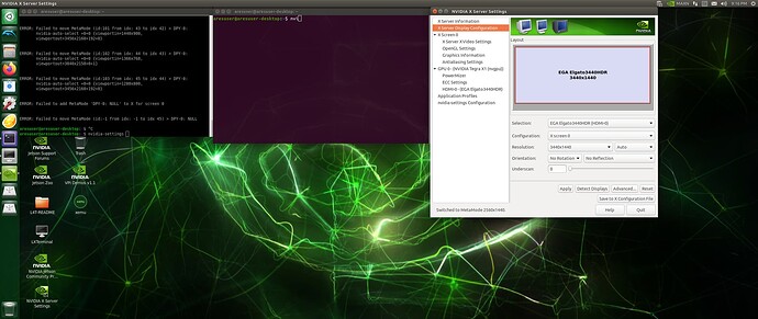

I have a problem that happens randomly
I have the xiaomi mi monitor https://www.mi.com/es/monitor34/
It detects it most of the time 4096x2160 24hz maximum resolution or 3840x2160 60hz
Instead of its native resolution 3440x1440 100hz for HDMI 2.0
with Display port detected corrected native resolution for this version can up to 3440x1440p 120hz.
Is it a driver bug/limitation?
Sometimes I find the resolution 2560x1440p @60hz under HDMI however it allows me 1080p 120hz
On the other hand, in display port it seems to me 2560x1080 @ 144hz but not 2560x1440p
It also enables me some non-real resolutions that it puts next to (scaled)

Ok thanks ModeDebug it’s very useful to the log I have been found
If I use a capture card This interacts with EDID Capture info and nvidia tries to read this EDID so seems it’s a capture EDID limitation the edid capture force to 4K UHD.
So problem solved, I’ll have to force the edid through a custom edid and load the resolutions from there.

Solved it Force edid to Screen instead edid by omition .
Although you have to tinker to support certain resolutions :P
Sometimes will be unstable for some reason and said Failed to move MetaMode NULL Dpy-0 and some consistences by Nvidia-settings
