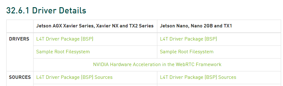

And refer to the Build Gstreamer Instructions it seems would not build libgstnvvideo4linux2.so.
Could you provide the nvvideo4linux2 plugin’s source code?
Thanks~
The source code package is in
https://developer.nvidia.com/embedded/linux-tegra
L4T Driver Package (BSP) Sources
Thank you for your help.
On Jeston platforms do Xavier NX, Nano and TX2 support the same hardware codecs?
It’s looks like Nano and Xavier NX build different libgstnvvideo4linux2.so.
It is different. If you also have Jetson Nano, please download the Jetson Nano package.
