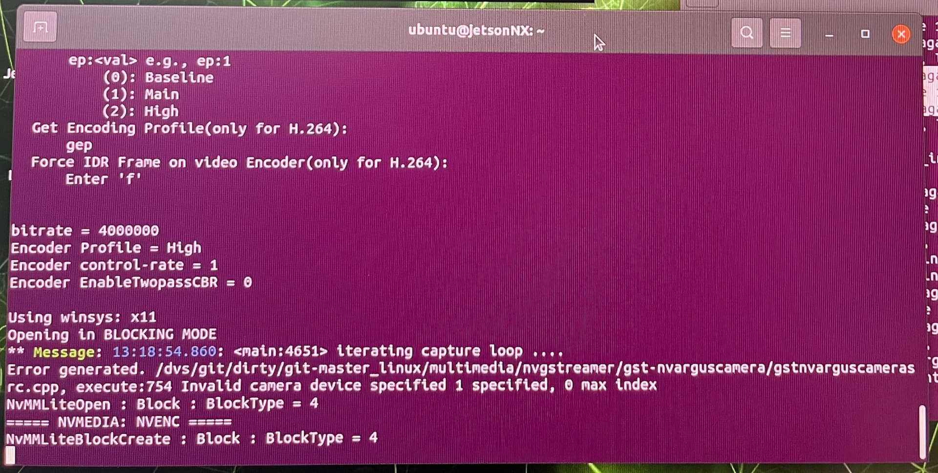

I have IMX477 camera on CAM1 (nothing on CAM0) and previous version of Jetpack 4.6 Rev works good.
but now with Jetpack 5.02 i keep getting
Note: if the camera is on CAM0 everything works, this only happen when moved the camera to CAM1 with Jetpack 5.02
command:
nvgstcapture-1.0 --sensor-id=1
error:
Invalid camera device specified 1 specified, 0 max index

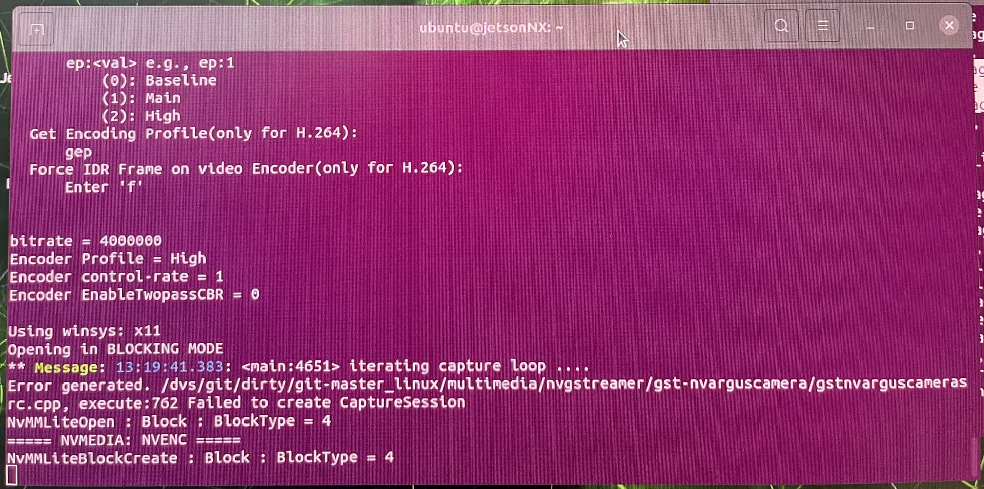

if i use “–sensor-id=0”
Did you enable two IMX477 by jetson-io?
of course both are enabled by Jetson-IO.py
Just verify without problem on my device.
Maybe try reflash the system image to try.
same problem, is there anything i can provide to you for further troubleshooting?
i have tried with 3 modules and all of flash with new Jetpack 5.02
Could you try if v4l2-ctl able capture successfully.
v4l2-ctl --set-fmt-video=width=1920,height=1080,pixelformat=RG10 --set-ctrl bypass_mode=0 --stream-mmap
