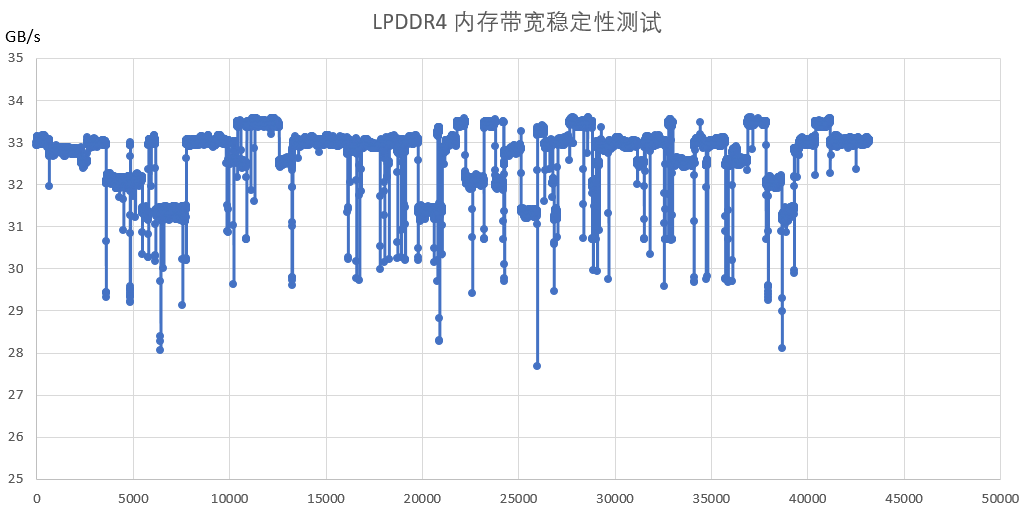

Hi Teacher,
When we ran the memory bandwidth stability test on Orin, the bandwidth kept jumping around a lot—like between 27.5GB/s and 33.5GB/s. Here are the test setup and commands we used. Could you mind taking a look at the config and see where we can tweak this test? Thanks!
The configuration is as follows:
  1. sudo nvpmodel -m 0 ; Max power
  2. jetson_clocks ;Frequence Max;
  3. Idle system;he system is running without any load;
    Test results:
Please share which command you run to do the test. And do you use Jetpack 6.2?
command : ./bw -n nproc -m rw -c 86400 -l -s 2g
R36 (release), REVISION: 3.0,
bw.zip (7.9 KB)
Please refer to the topic and run the mbw command. See if you get same result.
How to improve Orin module memory bandwidth - #16 by DaneLLL
