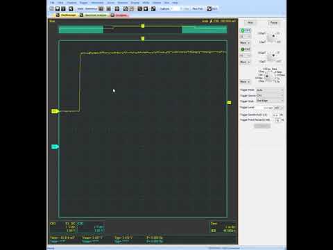

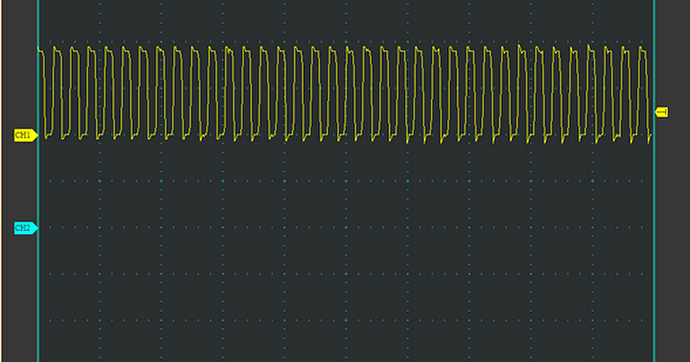

I checked DAP4_DOUT 40pin and related pinout signal as follows,
My Jetson Nano’s signal output has been strange.
Oscilloscope - Multi VirAnalyzer 2019-09-13 19-07-03-40pin-dap4-dout
Oscilloscope - Multi VirAnalyzer 2019-09-13 19-09-07-35pin-DAP4_FS
Oscilloscope - Multi VirAnalyzer 2019-09-13 19-14-54-12pin-DAP4_SCLK
it didn’t clearly indicate high or low level,and seemed to contain several megahertz signal or noise.

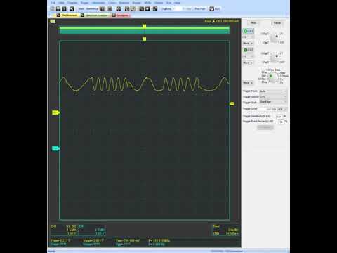

I noticed Drive Down / Up feature and tried as follows:
Driver Output Pull-Up/Pull-Down drive strength code.
Normally, the code is 5 bits
Pad Control Group Register
Address DRVDN DRVUP
DAP4_DIN 0x70000974 16:12 24:20
DAP4_DOUT 0x70000978 16:12 24:20
DAP4_FS 0x7000097c 16:12 24:20
DAP4_SCLK 0x70000980 16:12 24:20
sudo devmem2 0x70000978
/dev/mem opened.
Memory mapped at address 0x7fa5064000.
Value at address 0x70000978 (0x7fa5064978): 0x1010000
sudo devmem2 0x70000978 w 0x1616000
/dev/mem opened.
Memory mapped at address 0x7fad217000.
Value at address 0x70000978 (0x7fad217978): 0x1010000
Written 0x1616000; readback 0x1616000
it seemed to take some effect, but still didn’t indicate adequate high logic level.
Oscilloscope - Multi VirAnalyzer 2019-09-13 19-24-40-40pin-dap4-dout-drive-power-modified

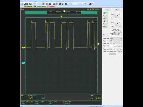

and I tested 40pin DAP4_DOUT and result is as follows:
I got 3.4MHz oshillation.
my application schematics is as follows:
I already tested it with Raspberry pi 3B+ exactly as same and it’s no problem.
Are there any other oversights?

Hello!
Yes you are correct, the upper nibble in the value 0x6044 is not applicable to this device and so you can ignore that. So yes the configuration looks better now.
The 3.4 oscillation looks like a clock to me. Stereo audio at 48kHz with 32-bit sample size would generate a bit clock of 3.072MHz.
Have you tried disconnecting your audio module to the Jetson Nano and ran speaker-test without it?

Jon-san,
Thank you.
But I already connected the probe directly to Jetson Nano.
Pin6 - Probe GND terminal
Pin40 - Probe tip
All signal patterns that i posted above are the same settings.
I also tested with my module and insert the probe to DAP4_DOUT.
due to my module specification, it must be clock master and frame master,
So I set as follows:
alsactl init tegrasndt210ref
amixer -c tegrasndt210ref cset name=“I2S4 codec master mode” 1
but I ended up to get a few MHz signal.
Again, I switch it to Rpi3B+ and got a sound as I expected.

Thank you for your special RMA support.
but, I tested again and got a same result.

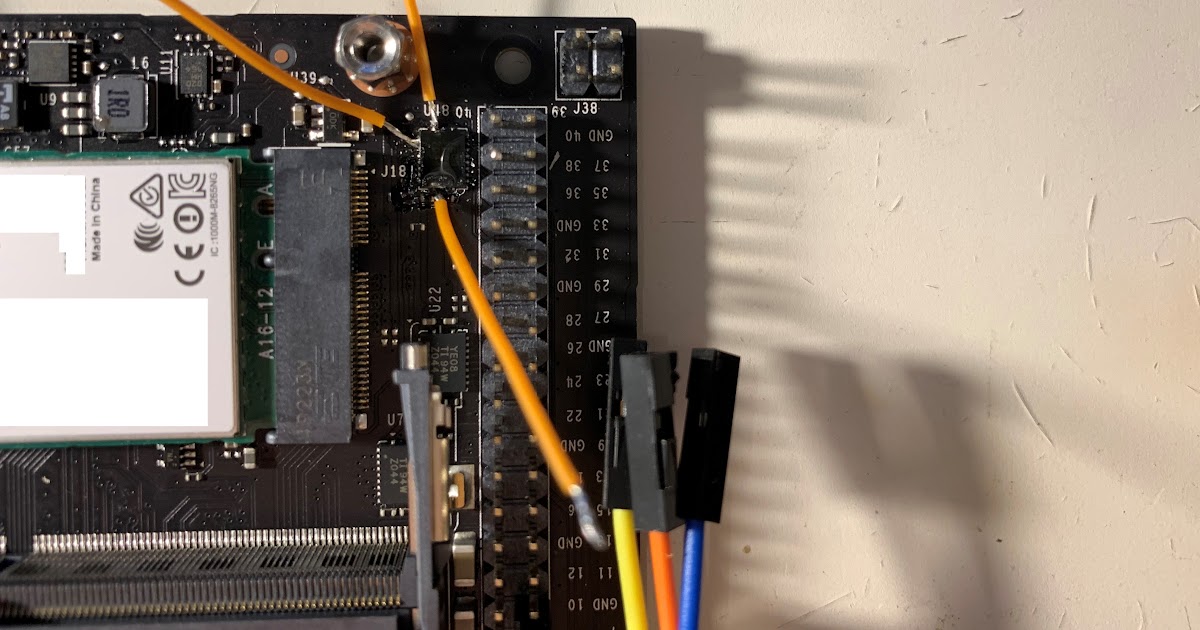

it seemed that TXB0108 behavior as U48 is a root cause.
I got a lot of support infos on TI website about it.
I decided to probe on 1.8v side of DOUT directly with take a risk of losing warranty.
I found a clean, ideal I2S waveform(DOUT,SCLK).
I will remove U48 and bypass A-B connect and arrange discrete level shifting circuit.
If there’s anyone who uses I2S interface, keep it noted.
I confirm the problem, only solvable by removing the U48 and applying another level shifter circuit.
Thank you.
I use SN74AVC4T774 instead of TXB0108 and it works as expected.
