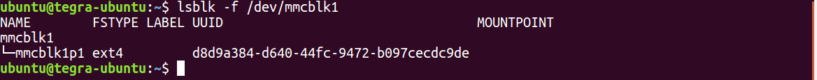

“/dev/mmcblk1p1” is the device itself. What do you see from:
lsblk -f /dev/mmcblk1
Attached image with the output I get. Also the same in text below:
NAME FSTYPE LABEL UUID MOUNTPOINT
mmcblk1
└─mmcblk1p1 ext4 d8d9a384-d640-44fc-9472-b097cecdc9de
Am I correct that this partition is not intended to be the root partition? If that is the case, and since there is no mount point, then boot should not be prevented or slowed down. Are you able to succeed with the following:
