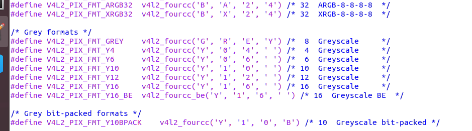

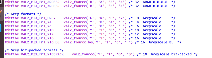

Hello @JerryChang ,
I searched a bit more in the source files and found a file named : videodev2.h where a lot of formats are listed (including greyscale) :
I see that a lot of grayscale are available : from 4 to 16 but not 14 so my question is : is grayscale14 possible or not ?
Adrien
hello adrien.leroy2,
that’s linux driver to define all the standards. so you could mapping the pixel formats into fourcc.
you may have a try since Raw14 is one of the supported CSI formats. (i.e. just as same we consider Gray8 as Raw8)
however, I’ve never test with Gray14 on Nano platforms, neither Raw14 did not verified on Nano.
