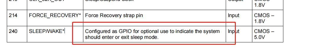

We use the custom carrie board and are trying to control NX suspend/resume by using pin 240 as document mentioned.

Hi, we can’t repro this on devkit, every time using pin240 will enter/exit suspend successfully. Can you share your schematic of it?
