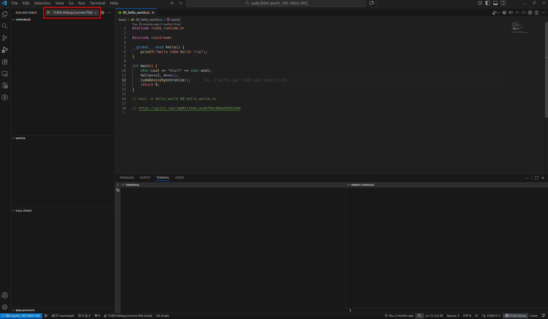

I’m encountering a segmentation fault when debugging even the simplest CUDA program using cuda-gdb on Jetson Orin AGX.
The program crashes immediately when entering the kernel function.

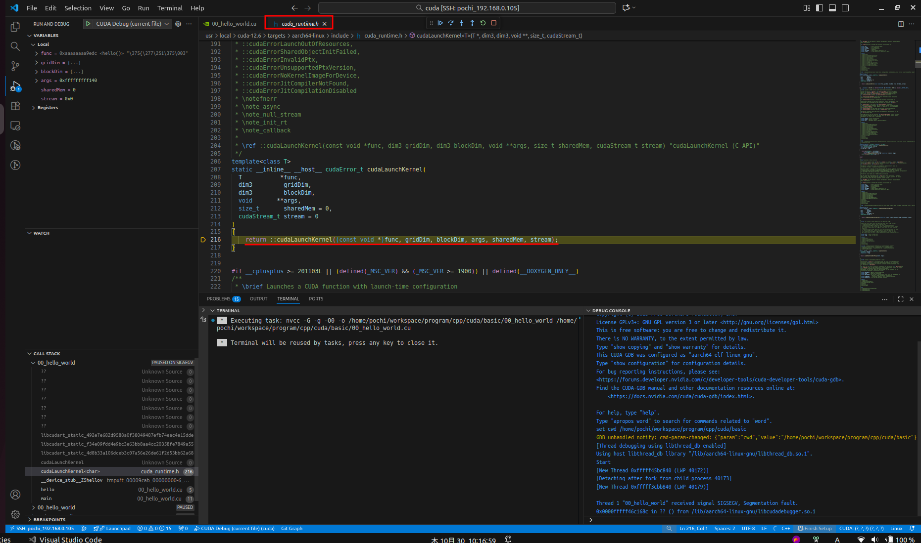

When launching the program under cuda-gdb, execution stops inside
/usr/local/cuda/include/cuda_runtime.h at this line:
return ::cudaLaunchKernel((const void *)func, gridDim, blockDim, args, sharedMem, stream);
and then immediately receives a segmentation fault:
Thread 1 "00_hello_world" received signal SIGSEGV, Segmentation fault.
0x0000fffff46c168c in ?? () from /lib/aarch64-linux-gnu/libcudadebugger.so.1
This happens even without any breakpoints.
CPU-side code runs fine, but as soon as the kernel is launched, cuda-gdb crashes.

launch.json (VS Code / Nsight VS Code Edition):
  "type": "cuda-gdb",
  "request": "launch",
  "program": "${fileDirname}/${fileBasenameNoExtension}",
  "cwd": "${fileDirname}",
  "args": [],
  "stopAtEntry": false
