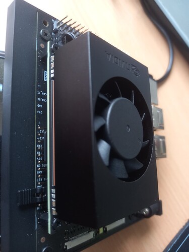

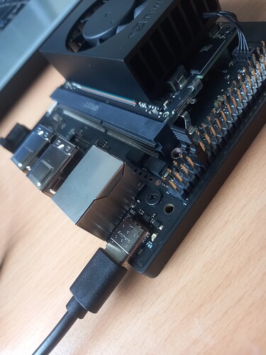

Could you share a photo of your usb connection and your jumper location?
Sure, here’s how I connect the USB and jumper.
You put the jumper in wrong location. There is another 12 pin header under the module.
Is it the right location?
Yes,
  1. remove the power cable
  2. short REC and GND pins
  3. plug in the power cable (device shall power up)
  4. connect the type C cable and check lsusb.
