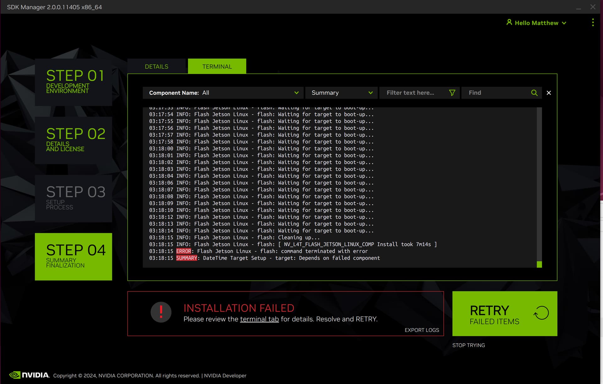

Unable to flash Jetson orin nano after a dozen attempts to nvme. Tried both nvme slots with multiple nvme drives which work on my other Jetson developer platforms. Always fails at 98 or 99%. I’ve used the same hp pc to successfully flash multiple jetsons, including another jetson orin nano, jetson orin agx, Jetson nano tx2nx, jetson nano. I’m not using virtualization. Also tried different usb-c data cables.
Thanks for any help you can provide
please let me know which logs will help to troubleshoot this and if there is a way to upload the full SDKM_logs_JetPack_6.0_DP_Linux_for_Jetson_Orin_Nano_modules… .zip file

The screen had a giant error message showing a failure, and after that I selected the export and it provided that zip file. I’ll go ahead and follow the article and provide the results. Thanks
Here is the error screen I received on my final attempt last night, I believe I tried again after I opened the ticket. I think switched to the 2230 NVMe with a different nvme drive. I’ll run the process you requested now.
SDKM_logs_JetPack_6.0_DP_Linux_for_Jetson_Orin_Nano_modules_2024-03-12_17-55-35.zip (123.7 KB)

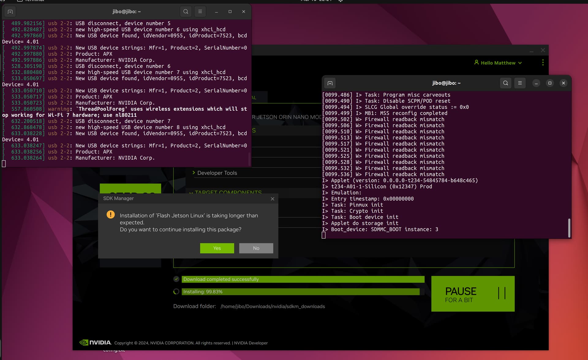

Ok, i have setup the ftdi and oddly enough nothing showed up in minicom when I booted the orin nano. Not sure what you wanted me to do afterwards, so currently running sdk manager to setup and minicom is display the flash process. Ill update with its output once complete and after attempting to connect when the setup completes or errors out, and any error logs if they recur. Is there something else I should try logging with minicom? Thanks
Just dump everything you get from minicom when flashing.
Hey Dave, here is the minicom log. I ran the process twice with the same results. It does prompt about taking longer than expected, but selecting yes just causes it to continue running without logging any new records into minicom. Choosing no displays the installation failure error. Powering off/on afterwords does not have any results showing in minicom
minicom.cap.txt (4.3 KB)
Is it a DevKit?
Try flashing manually under Linux_for_Tegra with the following command:
sudo ./tools/kernel_flash/l4t_initrd_flash.sh --external-device nvme0n1p1 \
-c tools/kernel_flash/flash_l4t_external.xml -p "-c bootloader/generic/cfg/flash_t234_qspi.xml" \
--showlogs --network usb0 jetson-orin-nano-devkit internal
Then attach log from both host and device.
It appears to have just hung again, must have been over an hour+
minicom.com.txt (4.3 KB)
out.txt (10.2 KB)

Hi, it’s been running 4 or 5 hours is that to be expected? Here is the current output:
