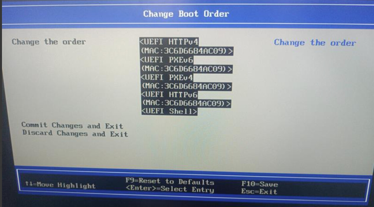

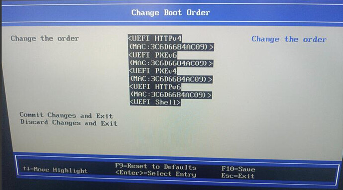

But after booting, we observed that it is booting to UEFI shell always.
We went in to Boot manager and checked and found that NVMe is not listing even though it was successfully flashed.
  1. Any idea why this issue is happening?

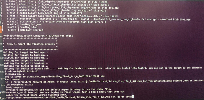

  2. Also if we try to do restore , then we get some error saying
    “your are trying to flash images from a board model that does not match the current board your flashing…”.
Pls help us to resolve this.

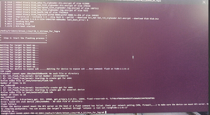

Some more updates:
We tried flashing the unit second time, it failed during the flashing process this time saying : could not stat /dev/nvme0n1
I think you already knew about that… you should check your UART serial log.
And please share your full flash log as text. Screenshot only provides poor quality.
Yes. We realized it bit later as it was long time, we came across this issue of /dev/nvme0n1 causing problem during flashing.
Checked with the hardware team, probably the mounting of NVMe is not properly on the carrier board. We are trying to flashing again on the properly mounted NVMe and let you know.
Pls close this thread.thanks
This was some hardware related issue, the external NVMe on the carrier board was not mounted properly. After some touch ups in the circuitry it started detecting NVMe and booted fine.
