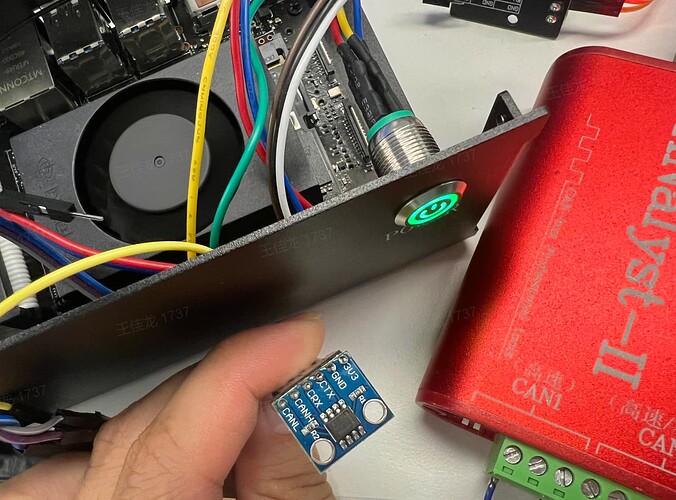

Jetson orin nx :can “candump can0” Messages cannot be received, but “cansend” can be sent
Thank you very much for your support, the problem has been solved, it is indeed a module problem of conversion. After using module “SN65HVD230”, it can work normally. This is really what I didn’t expect. Thanks again.
(1)Real experiment
(2)orin receives and sends
(3)PC receives and sends
(4)The following is the hardware connection block diagram
