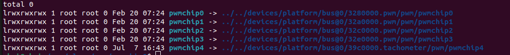

To whom it may concern,
I’d like to summarize my questions below:
  1. Which pwmchip should I use for GPIO07 (Module Pin 206, Header Pin 32)?
  2. Where is the default DTS or DTSI file located?
Additional context for Question 1:
  • JetPack version: nvidia-jetpack 6.2+b77
  • Below is the current default status of the PWM devices:(Insert relevant output or attach)
  • Here is the current pwmchip information:(Insert relevant output or attach)
From both Jetson-Orin-Nano-DevKit-Carrier-Board-Specification_SP-11324-001_v1.3.pdf, I’ve confirmed that GPIO07 maps to Module Pin 206 and Header Pin 32, as shown below.
However, I haven’t been able to determine which pwmchip corresponds to GPIO07.
Could you please point me to any documentation or resources that can help clarify this? I would greatly appreciate any guidance you can provide.
Thank you for your time and assistance. Please let me know if you need any additional details or have further questions.
Sincerely,

Hi will.huang.oksi,
Maybe you can refer to https://elinux.org/Jetson/L4T/peripheral/#Mapping_4) for their mapping.
You can find the source for pwm@32e0000 in tegra234.dtsi, or just configure it in tegra234-p3768-0000+p3767-xxxx-nv-common.dtsi
Hello @KevinFFF
thank you for sharing the link which is very helpful!!!
Here is my follow-up question and let me know if I should create another thread instead.
I am configuring PWM output on GPIO07 (Pin 32 / AUD_MCLK / PG.06) using the 32e0000.pwm controller (pwmchip3) on a Jetson Orin NX.
My goal is to generate a 67.5 kHz PWM signal at 50% duty cycle.
I confirmed the pinmux is correctly configured via:
sudo busybox devmem 0x0243D000 w 0x4
cd /sys/class/pwm/pwmchip3
echo 0 | sudo tee export
cd pwm0
echo 29850 | sudo tee /sys/class/pwm/pwmchip3/pwm0/period
echo 14925 | sudo tee /sys/class/pwm/pwmchip3/pwm0/duty_cycle
echo 1     | sudo tee enable
and the PWM output does appear on the expected pin.
I tested the following period and duty_cycle values:
  • period = 14925 ns, duty_cycle = 7462 ns → measured: 132.8 kHz
  • period = 29576 ns, duty_cycle = 14788 ns → measured: 66.4 kHz
  • period = 29308 ns, duty_cycle = 14654 ns → still 66.4 kHz
  • period = 29800 ns, duty_cycle = 14900 ns → still 66.4 kHz
  • period = 29850 ns, duty_cycle = 14925 ns → still 66.4 kHz
Despite varying the period across a 500 ns range, the output frequency remains locked at 66.4 kHz, which suggests quantization to a fixed base clock, likely 132.8 MHz, with integer divisors.
Could you please clarify:
  1. What is the exact base clock driving 32e0000.pwm on the Orin NX?
  2. Is it possible to achieve more granular PWM frequencies (e.g. 67.5 kHz) using this controller?
  3. Can we configure a custom clock divisor or adjust the parent clock rate to improve resolution?
Again, thank you for your precious time on this matter.
