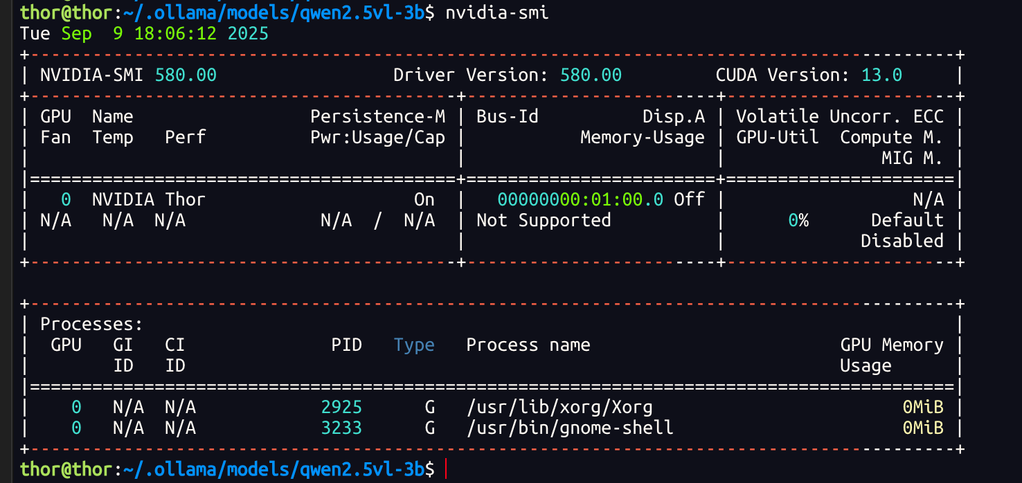

Hi:
You might need to use nvidia-smi to monitor GPU usage, as described in Thor GPU can not detected - #5 by AastaLLL
please see other my question: Jetson thor: nvidia-smi show Nvidia thor off
What about watch -n 0.1 nvidia-smi?
Run nvidia-smi will check the usage just once. Use watch to check it every 0.1 second.

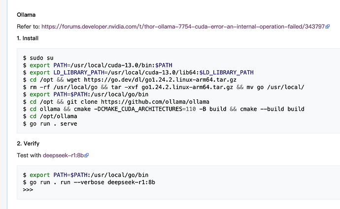

Could you check if your Ollama has CUDA support? (libggml-cuda.so)
Or you can install it from the steps shared in the link below:
I follow the link step, only get libggml-cuda.so/libggml-cpu.so/libggml-base.so file , but no have the file “ollama”:
But, I pull docker image : “docker pull Package ollama · GitHub
In the docker, I get the /opt/ollama files;
so In this way, I finally solved the problem that ollama compiles the source code without ollama executable program;
thanks for your answer, And share my solution with others;
