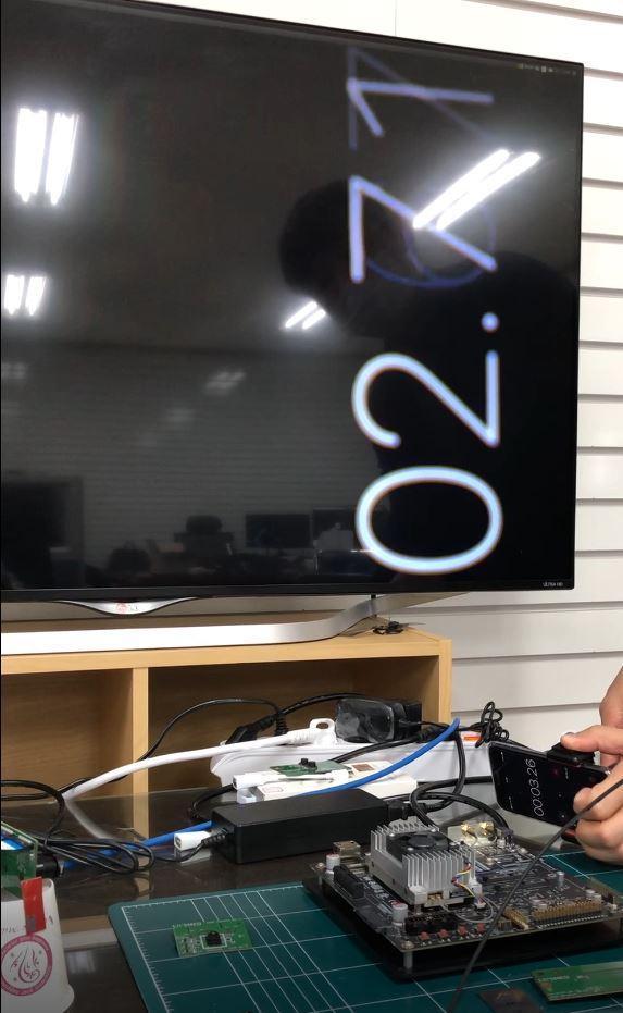

I tested to measure by capture delay from custom image sensor to display monitor as shown below picture.
test condition is 24Mp ( 5706x4312) / 30fps.
it took 0.56 seconds.
i want to reduce capture delay to 0.09s.
Please, How to minimize delay time.

Hello JerryChang ,
  1. could you please share the commands you’re using for your 560ms evaluation results.
    As you shown above picture, image sensor captured smartphone stop watch app.
    at this time , it captured both smartphone display and display monitor by other smartphone camera.
    560ms is difference stopwatch time of monitor and stopwatch time of smartphone.
  2. you may note that [B] depends-on your sensor frame-rate, for example, it’ll take 33ms for your 30-fps sensor modes.
    I understand
  3. may I know you’re asking to reduce the capture delay to 90ms from [A] to [D].
    Yes, I want to reduce until 100ms~90ms from [A] to [D] minimally.
