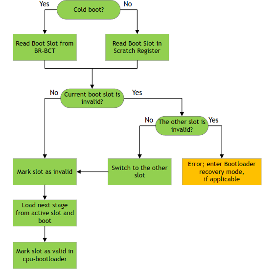

I suspect that when the client put power low the board cut the voltage before that the cpu-bootloader has time to mak the slot as valid , please refer to this schema.
Is there a way to tell the bootloader to always mark slot as valid , is only for test purpose just to make sure that’s the problem.
