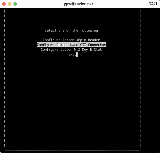

Hi, everyone, I just got my Xavier NX.
I want to run RaspberryPi HQ Camera on Xavier NX.
I have edited /boot/extlinux/extlinux.conf to load new DTB file, but dmesg shows old DTB build time, and IMX477 is not the default camera.
/opt/nvidia/jetson-io/jetson-io.py: Camera IMX477 Dual

hello 915505626,
could you please share your steps to configure with Jetson-IO,
there should be *.dtbo generated, it’ll load that device tree while rebooting.
sudo /opt/nvidia/jetson-io/jetson-io.py

hello ypw,
there should be two boot options,
instead of using primary label, did you select JetsonIO from the boot-up menu for verification?
Problem solved.
My jetson is jetson-xavier-nx-devkit-emmc, must use this command to flash dtb:
sudo ./flash.sh -k kernel-dtb jetson-xavier-nx-devkit-emmc mmcblk0p1
