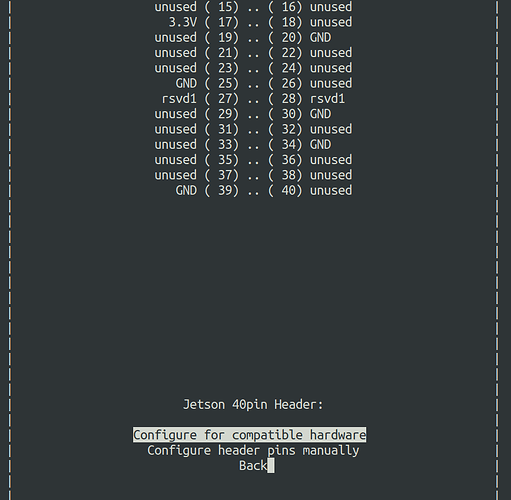

hi @ShaneCCC ,
i flashed on the new SOM and did the changes in jetson io tool , but still i could not see the user-custom.dtb in boot folder?
You are using customized carrier board?
Can you run the jetson-io and save but don’t reboot to check the file.
hi @ShaneCCC
yes i am using customized carrier board.
I did saved file without rebooting still i could not find it in boot folder.
How about export to file?
I donot have this option
Configurate header pins manually → select any of pins → back → Export as device tree overlay.
