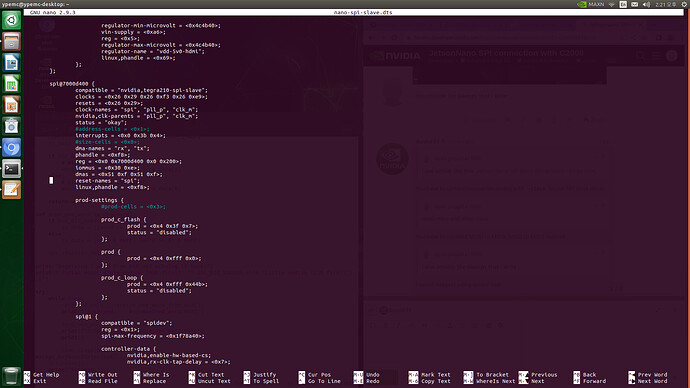

in this state the jetson receive but rather than value that i send {0x55AA, 0x44BB, 0x33CC, 0x22DD, 0x11EE};
jetson receive random number like this.
i also provide the slave.py that i write
You have to update compatible string with -slave to use SPI slave driver.
You have to connect MOSI to MOSI, MISO to MISO instead.
I would suggest using spidev tool.
you mean this?
so my bad, before this the slave mode is not activated. but after its activated and using MOSI to MOSI, MISO to MISO in slave mode the jetson showing me this.

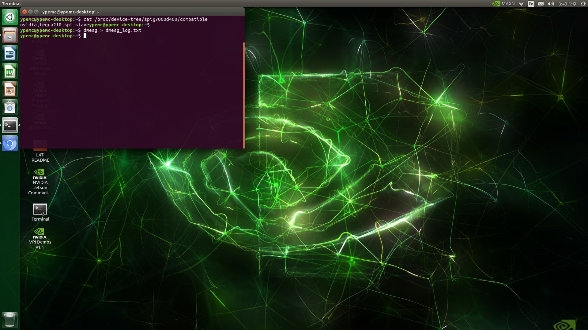

Please refer to https://elinux.org/Jetson/L4T/peripheral/#Slave_Mode to know how we verify SPI slave on Jetson.
And also share the full dmesg for further check.
i done it at it verified in the first line of this figure.
and yes the slave.py i written it myself as i dont find reference for this.
and i attach the dmesg here:
dmesg_log.txt (97.3 KB)

Please try configuring tegra-spidev instead of spidev as following.
		spi@1 {
-			compatible = "spidev";
+			compatible = "tegra-spidev";
			reg = <0x1>;
			spi-max-frequency = <0x1f78a40>;
			controller-data {
				nvidia,enable-hw-based-cs;
				nvidia,rx-clk-tap-delay = <0x7>;
		spi@0 {
			reg = <0x0>;
			controller-data {
