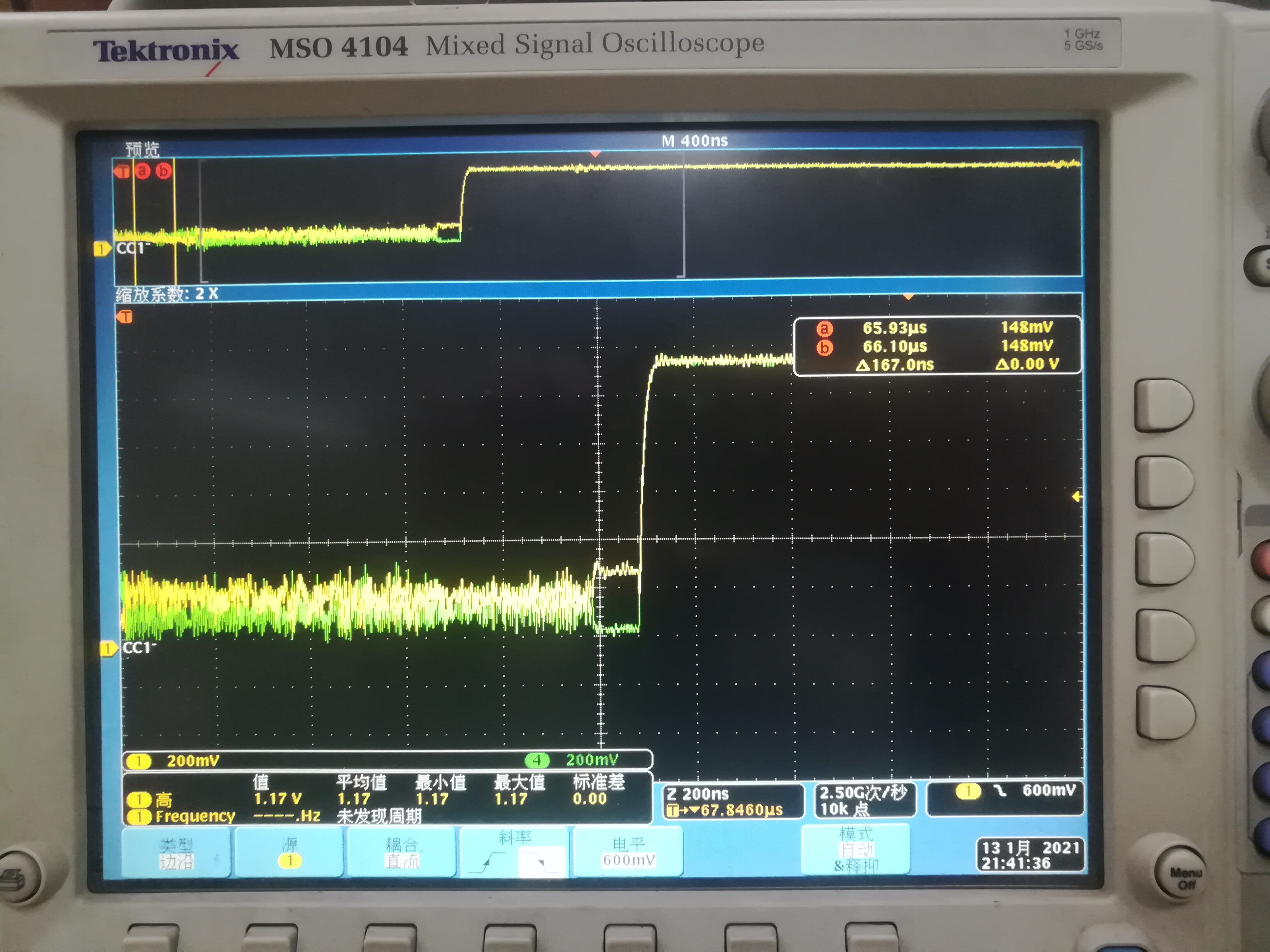

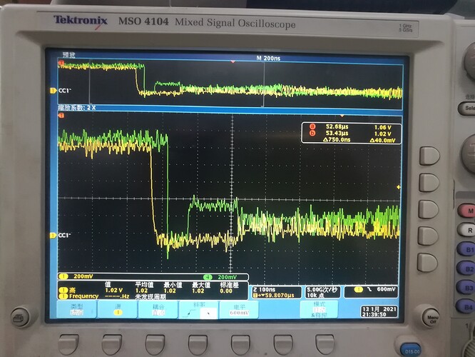

JerryChang:
The attached pictures are start-of-frame and end-of-frame signalings.
Is there any problems?
hello ycl,
these MIPI signaling results looks correct as normal workable sensors.
since you’re having the signaling; please check cil_settletime, by default it’s setting to 0 for the driver attempts to auto-calibrate. you may assign THS settle time of the MIPI lane, unit is in nanoseconds.
BTW,
are you able to enable test-pattern-generator on your Ser/Des chip?
thanks
According to the picture uploaded, can I set THS to 400ns?
Why can not use cil_settletime auto-calibrate?

hello ycl,
you may refer to TRM for the formula of THS settle time,
for example,
85ns + 6 * UI < (Ths-settle-programmed + 6) * lp clock periods < 145ns + 10 * UI
