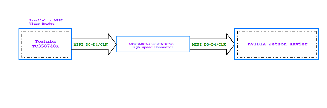

Hi
attachment is our MIPI diagram .
Use these two methods to test,

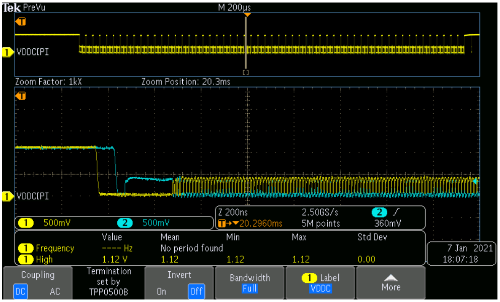

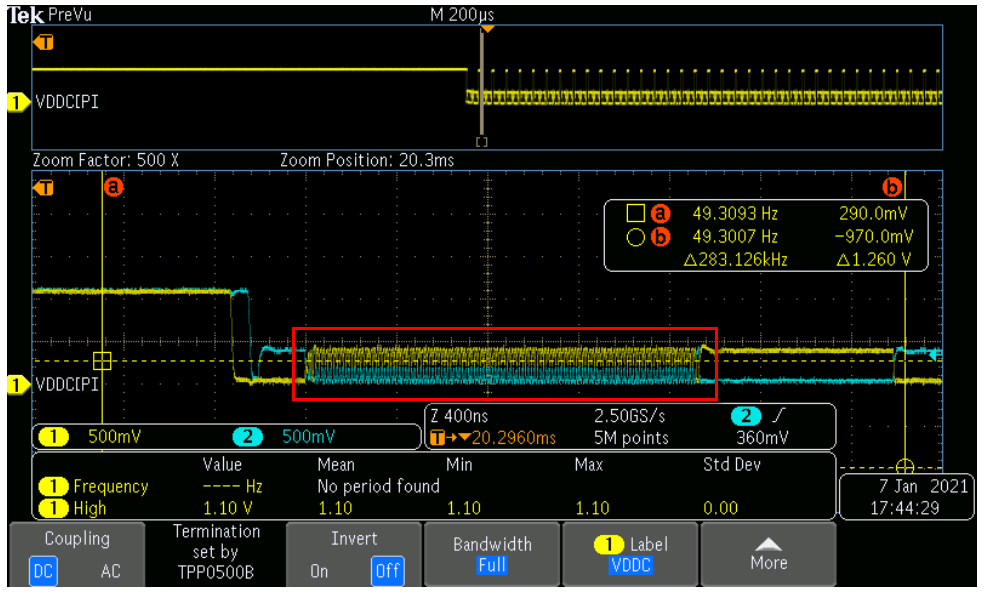

lan0+/- waveform :
Picture 1 : Toshiba MIPI out , not connect to nVIDIA
Picture 2 : Toshiba MIPI out and connect to nVIDIA
Red frame show the data are cut in half.

Do you have any suggestions? Thanks.
Try to boost the nvcsi/vi clocks to check.
https://elinux.org/index.php?title=Jetson_TX2_Camera_BringUp
Thank you for your support , we fixed this issue.
Hi @kimichang
it‘s mipi signal issue?
Hi suchb
Our problem is mipi format ,because our Mipi signal generate by FPGA.
If you use standard mipi format and follow nV dwsign guide, I think it should be work normal.
FYI
